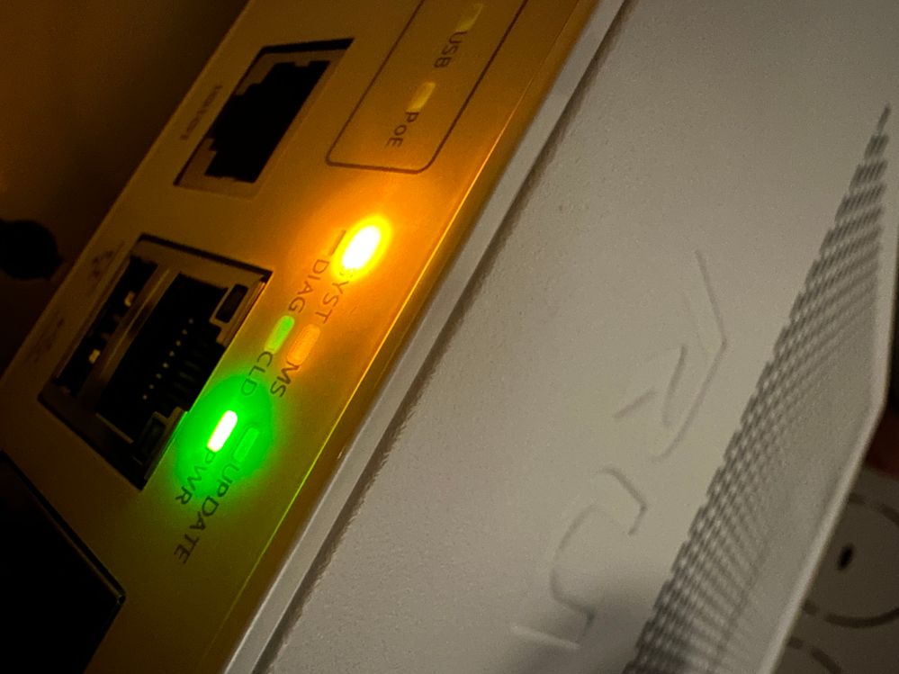

We had a recent power outage and the access point within the home are not working. In the past I have been able to power reset these systems and they reboot effectively. This time this has not worked and it seems that my Ruckus system is stuck in boot mode with an orange light for SYST and a green light for power.
I have spent a couple days looking over similar posts about this topic and have tried resetting the device and have installed the drives, upgrade, putty, MobaXterm, and other things. None of these seems to work at all and have just led to me wasting hours.
The issue with the rest and that all the lights flash orange for hours and nothing actually happpens.

Hi @ClemTigers

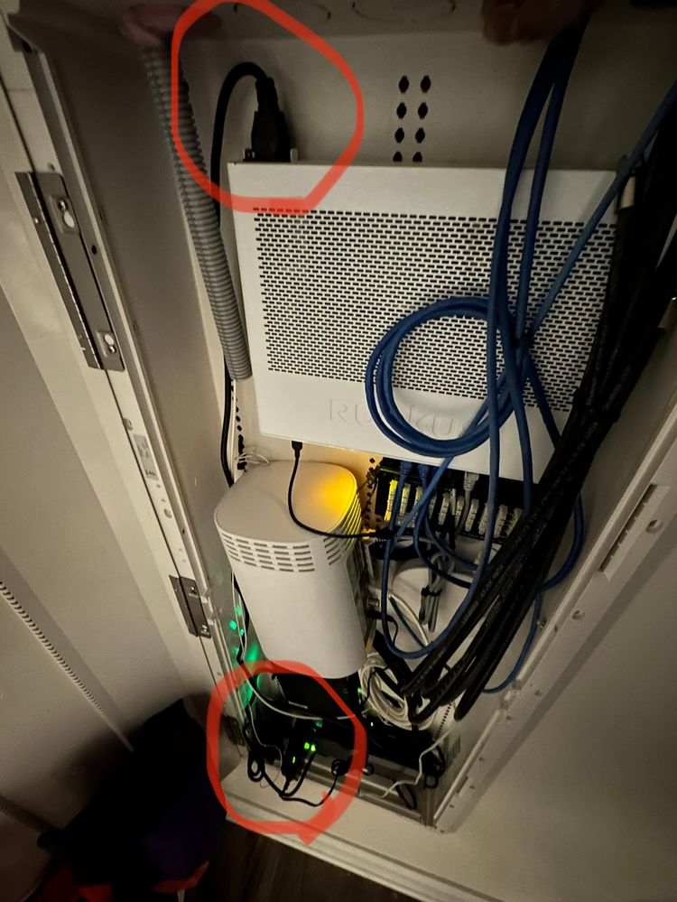

Could you please plug your ICX-7150-C12P Switch into a working power outlet and send us PICTURES of it showing the light status, and cord connected to the Switch and power outlet? Please refer to the below pictures as an example.

Note the router that is working is plugged into the same outlet.
Hi @ClemTigers
Thank you for the response and for sharing the requested information.
This Switch unit Should be RMA (Return Merchandise Authorization) in simple words replacing it.
