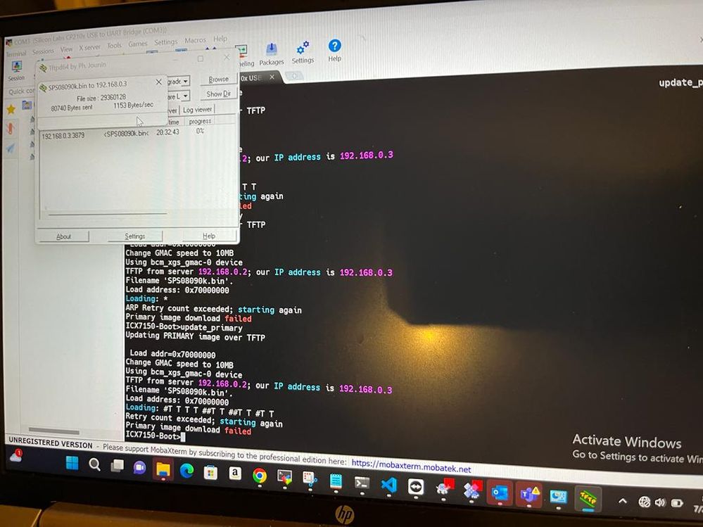

The steps were completed successfully (though I could see lots of crash messages on the console), still, the device only has 2 lights as shown in picture and wifi extender does not power on.

@Jayavidhya, what do you mean not done correctly? The ping is successful , but not always, sometimes it says successful ping, but when we give the command update_primary, we can see
Loading: # T T T T # # TT
retry Count Exceeded, starting again
Primary image download failed
We can also see TFTP Dialog opening up & starts sending bytes (see sceenshot), saying 80740 bytes sent. We followed the exact steps in the article you just gave. Please see the screenshot properly. It has the TFTP Dialog & console output, you can see the data transfer fails. At the end it says, Primary image download failed. We're stuck here, it does not move forward, we tried multiple times. Same result.

Based on the images you have shared it seems like the files were not downloaded properly. Please follow the steps correctly and let us know the result.
Also please share the screenshot of the image showing ping successful message.
