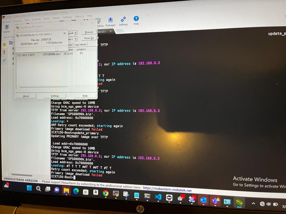

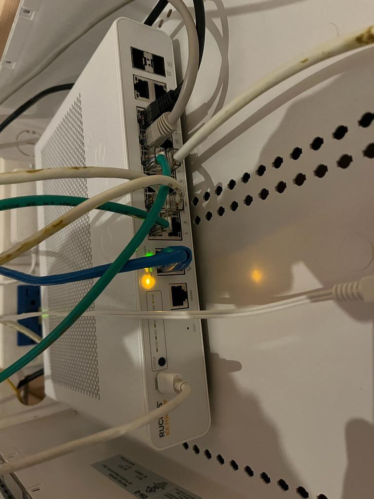

The steps were completed successfully (though I could see lots of crash messages on the console), still, the device only has 2 lights as shown in picture and wifi extender does not power on.

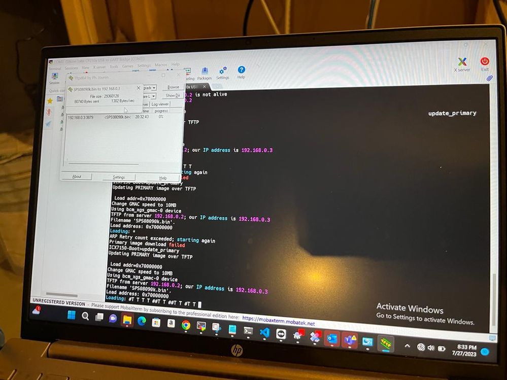

We of course had connected console cable A console cable from the Computer to the ICX 7150 Switch Type-C USB console port and Ethernet cable connected between the Out-of-band management port (port 13) and our computer's Ethernet port. We were able to copy the files through TFTP but the problem is still not solved.

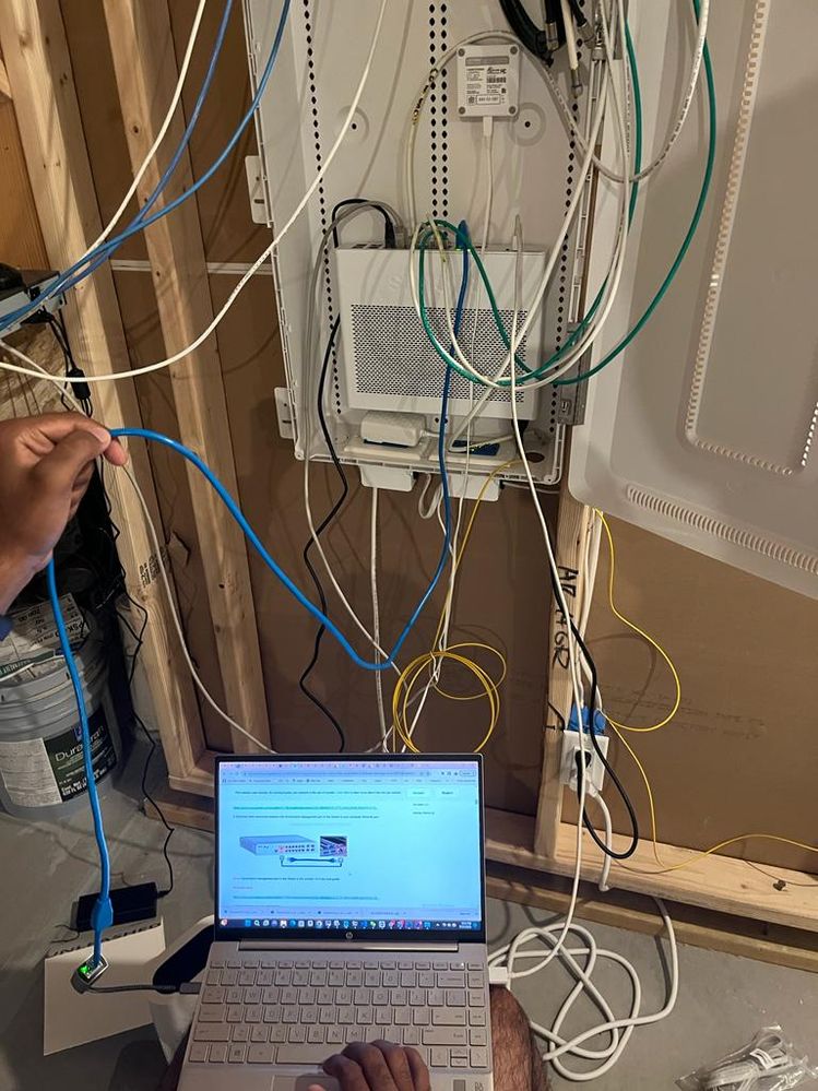

Hi @sebastso
Please share image of the switch and the computer showing the console connection.
Please try to follow the steps in putty application and check whether you are getting the same issue or not.
While following the steps if you facing any issues please share the screenshot of the error you are getting.

Hi @sebastso
Thanks for your response.
To complete software recovery process please enter the following commands and let us know the results.
“setenv image_name SPS08090k.bin” (enter the correct image file name)
“update_primary” (upload the image on the primary partition)
“update_secondary” (upload the image on the secondary partition)
*Wait that loads the image and continue with the boot:
“setenv uboot mnz10115.bin” (enter the correct boot file name)
“update_uboot” (upload the boot code)
* Wait that loads the boot and continue with the Final command reset:
“reset” (finally enter reset to reload the unit)
Tutorial video: https://www.youtube.com/watch?v=RHriOYYD_iI
