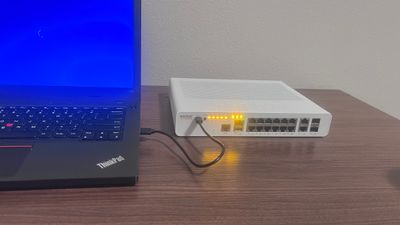

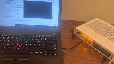

Hi @ LDahal
Please provide an image/photo where you are trying to connect via console from ICX 7150 - C12 P (USB type C to USB ) to PC. Before uploading the photos please login to the RUCKUS account and you can upload the image.

I was still trying to follow all step closely. All downloads and setup, creating upgrade folder are done. Configure Tftd64 done. Then I open putty and set up serial as com3( which was found on device manger< ports). After that putty opens with black screen only. I could not write anything on it.

Hi @LDahal
Thanks for the details provided, based on the troubleshooting you have done since the console port is not responding, this unit must be RMA(Return Merchandise Authorization), which means to replace it.
Contact us via chat(I will add the Link), comment that you already have a post in which we have already approved the RMA, copy the link of this post and paste it into the chat to initiate the replacement of the unit.
The next link below is the chat to open the RMA case.
