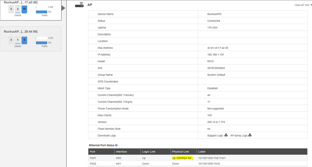

Here's a screenshot from the ruckus portal.

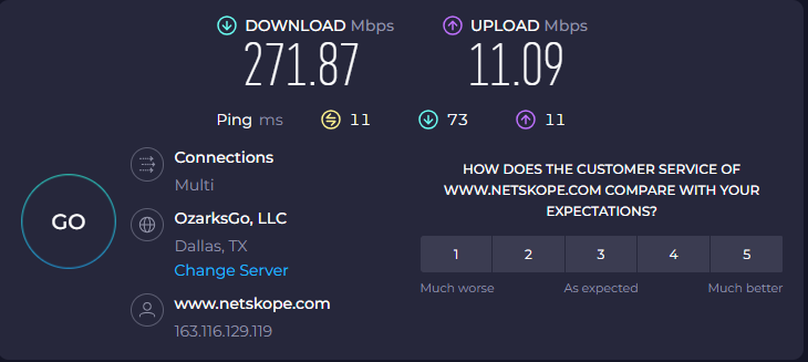

Hello,
Please see the screen shots from speed test.

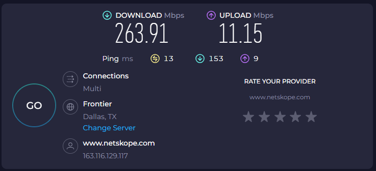

1. SpeedTest from ISP router on Wi-Fi

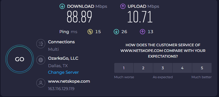

2. Speed Test from Master AP(which show's up to 100mbps speed on ruckus portal)
3. Speed Test from member AP(which show's up to 1000 mbps speed on ruckus portal)
My question is, why is Master AP capping the speed to 100 MBPS when member AP shows 1000 MBPS. I understand that maximum speed is decided by the ISP but Master AP shouldn't be restricting it unlike member AP. is there a config that I should be looking at?

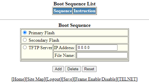

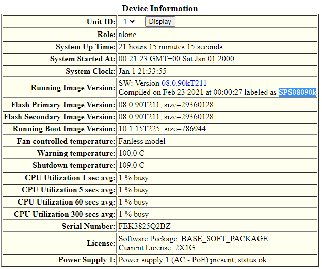

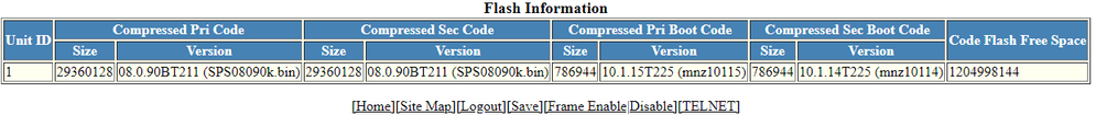

I don't have any of these symptoms. I am only concerned about the speed capping at 100 mbps from only 1 AP. if its an issue from the Switch itself, then it should cause problems at both AP's not just one of them. Please see screen shots from switch's GUI. it shows its loading from primary. Please guide me on next steps.
