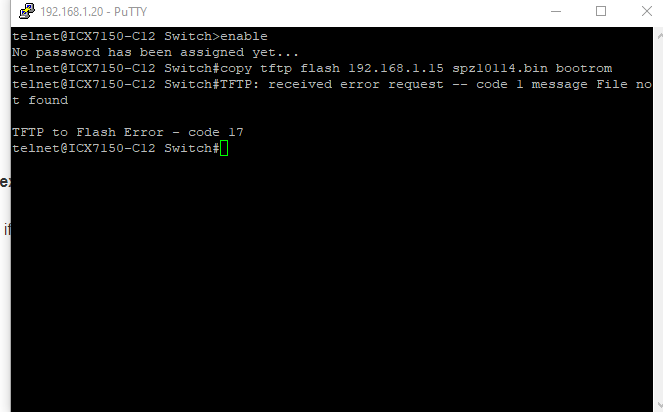

This is what I am getting so far

Hi @bkpatel009
Thank you for the update.
Yes that is right, please proceed with the next steps as explained in my previous post.
Please share a screenshot of error (if any) and let me know if you are stuck at any point or have any queries in this regard.

Hi @bkpatel009
Could you please check and confirm if you have created a separate image folder as highlighted in the screenshot below? (Folder name is ‘Upgrade’ in below screenshot example)
Also please make sure, TFTP is correctly configured with the correct folder and Server interfaces as marked in the below screenshot as an example.
Please check and confirm once. And share the screenshots of the same.
