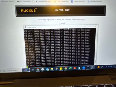

Based on the troubleshooting conducted and our discussion in private chat, it appears that your ICX-7150-C12P Switch is consistently encountering a fatal PoE error when attempting the upgrade through various methods on the CLI. Despite trying all available options, the issue persists. It’s a symptom of hardware failure. Therefore, the most appropriate course of action would be to initiate an RMA (Return Merchandise Authorization) for the switch unit, essentially replacing it.

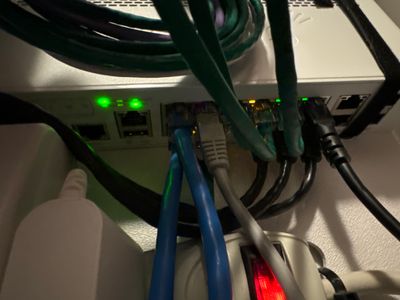

  • I can confirm there is wired connectivity from the switch. In the picture, The black ethernet cable farthest to the right is connected to my computer and it is green lit.image.jpg
  • other smarthome devices connected to the switch works
  • There are no power to the 2 AccessPoints. No lights on both APs and there are no light in the ports where the 2 blue cable are plugged in.
  • I had tried to switch the AP cable to different port but still no light on and no power to the AP.

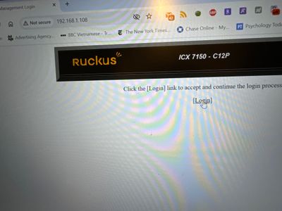

  • I had identified the IP address of the switch and get to the login screen, but unable to login using my dashboard password. 

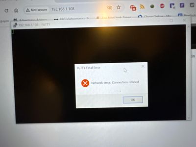

  • I had downloaded putty and ruckus driver to try console in the switch, but getting this error while typing in the IP
  • when selecting Serial for USB instead of IP, I got the "PoE Fatal: Vmain (48V) fault has forced all ports on slot 0 to lose power." That keep running nonstop.
Please let me know if there’s anything I can do to resolve this issue. From the support articles I read, looks like I’d have to do a factory reset. However, I am concern that I cannot do it with the ability to access the console’s dashboard or command line?

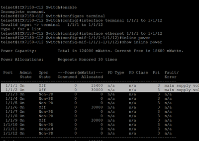

I had also tried to enable the PoE per another post, and after that all 12 ports have admin state now. However,  the 1/1/1 and 1/1/2 port where the APs plugged in still have that "main supply voltage low" error.
