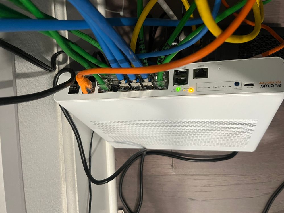

On your switch while it's plugged into the outlet, do you see any lights on? (Amber or green) Please let us know which lights are on. (Please refer to the below picture and share a picture of the same, showing the light status and the FULL Switch panel cable connections to the Switch ports)

When the ICX-7150-C12P is plugged in, the power is green and the SYS is orange. There are no lights on the other switch ports.

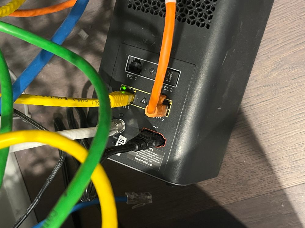

I have also included a picture of the modem. The orange line from the modem is connected to the switch.
Power - green & SYS - Orange
Modem - Orange line from modem is connected to ICX-7150-C12P

I see from the picture you shared, that your RUCKUS ICX-7150-C12P Switch has an Orange/Amber light on SYST and Green on PWR. This means the Switch is stuck in the boot mode.
