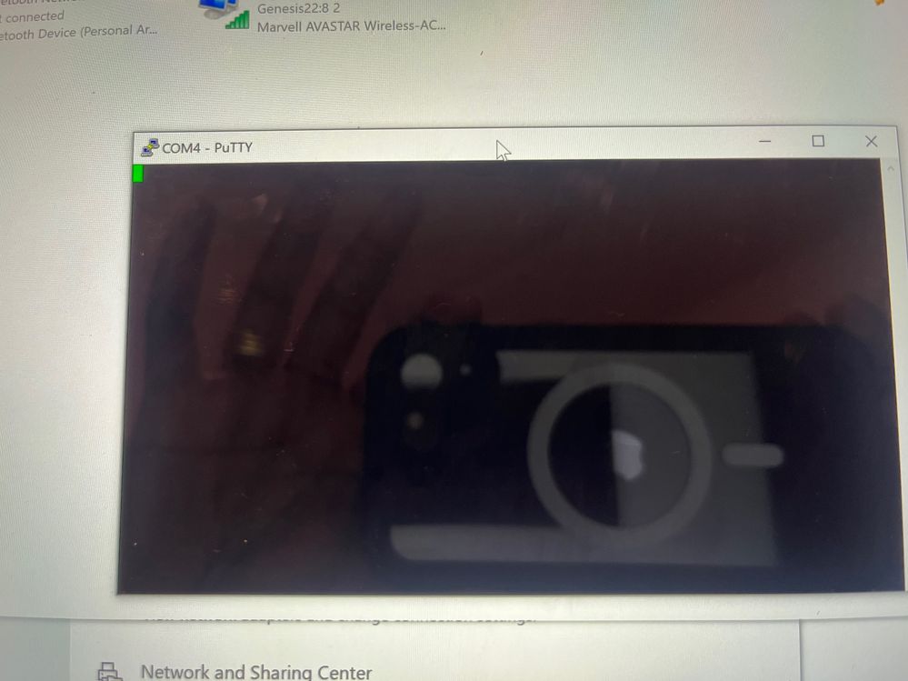

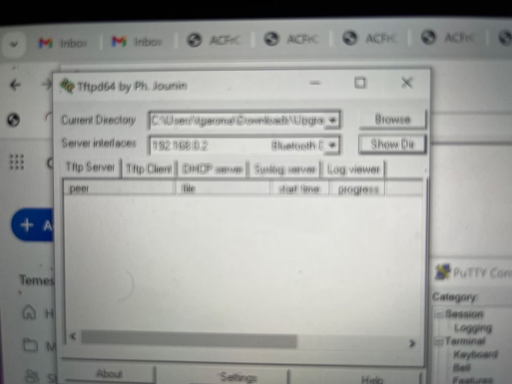

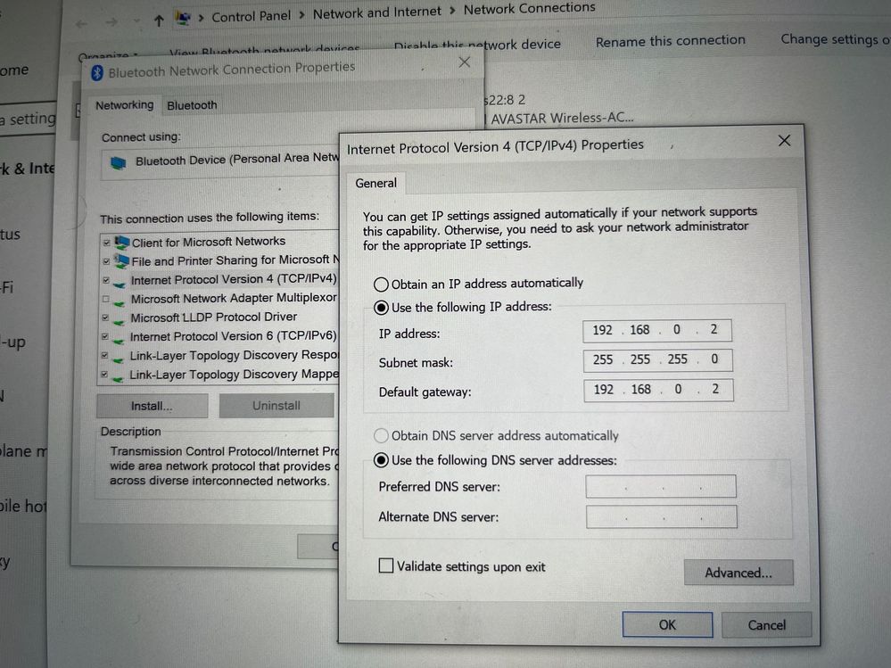

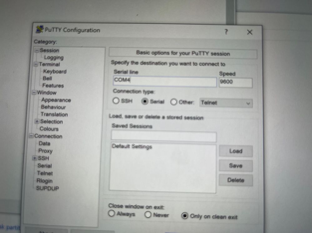

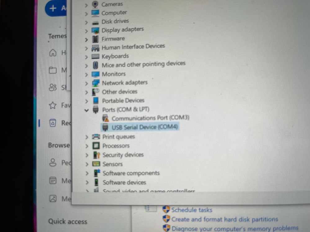

I have followed the guidelines and stuck at the following.
I used Microsoft Surface Pro for this purpose. I used a USB (data cable) to connect the switch to the Surface Pro (the switch is detected by the Surface Pro).

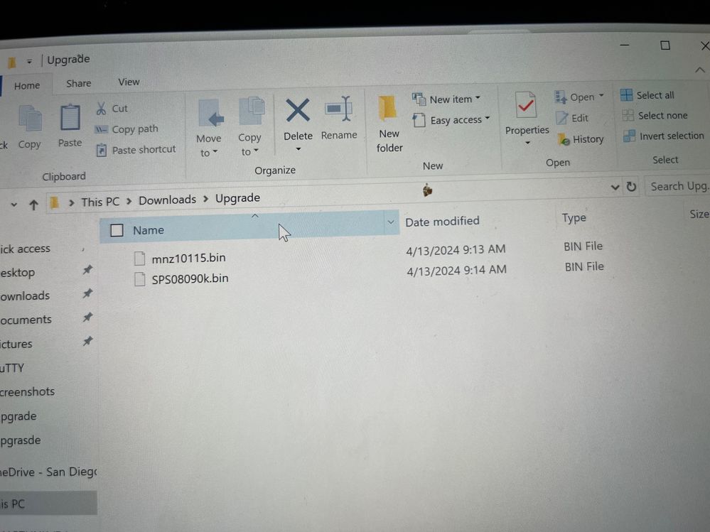

Downloaded Putty and TFTP on the Surface Pro.
Downloaded the firmware.
Assigned IP address
When the putty was launched, I got a blank screen . I DID NOT GET  "boot>" as anticipated
I have attached pictures of each step. Please advise what to do next.PortPortTFTGTFTGIP assignmentIP assignmentblank puttyblank puttyfirmwarefirmwareputty configurationputty configuration
Hi @tgaroma
Could you please let me know if you installed the RUCKUS ICX-7150-C12P Switch drivers in your laptop?
If not, please make sure to download the zip drive for the file below & "extract all". Once it's extracted, run the file,  driver should be installed. Then you can retry once.
Link:https://support.ruckuswireless.com/software/1414-brocade-ruckus-7150-usb-serial-driver-windows
Link: silabs.com/developers/usb-to-uart-bridge-vcp-drivers?tab=downloads
Imran,
I installed both and that didn't solve the issue. Please advise what would be the next.

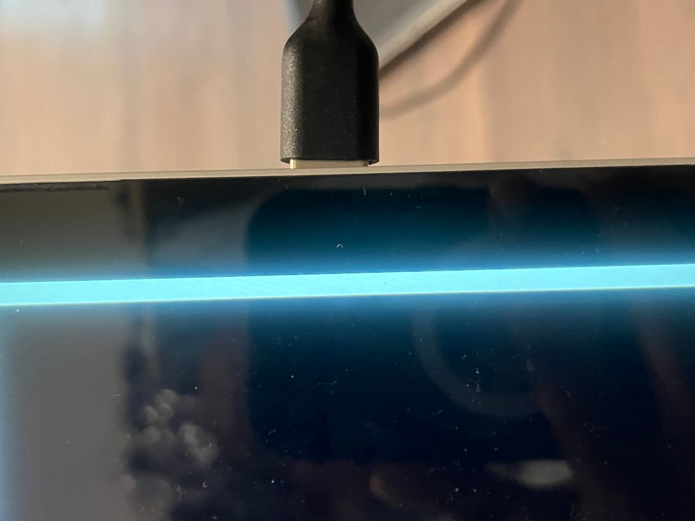

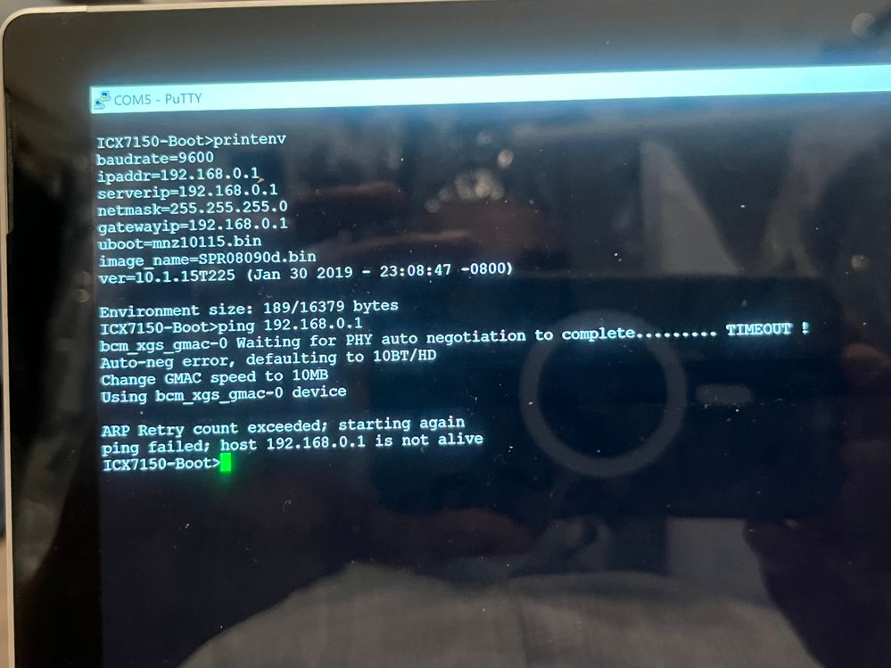

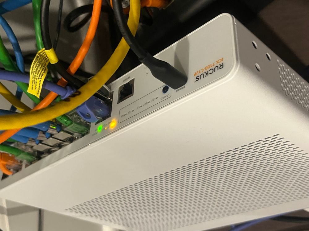

I have worked on it over the weekerror mesageerror mesageconnection to computer - a normal USBconnection to computer - a normal USBconnection to switch - Type-C USBconnection to switch - Type-C USBend. I did make progress, but this time I am getting an error message ... TIMEDOUT. I have attached pictures of the error and the connections.
FYI.. For the connection, I used a USB console cable with a Type-C connector (on one side you will have a Type-C USB and on the other side a normal USB). See the pictures attached.
