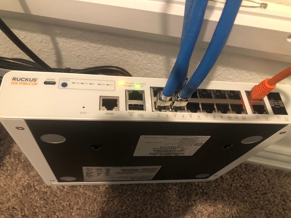

I see that my Ruckus ICX 7150-C12P installed by Lennar is not sending any power to R510 AP's.
I see only 2 lights on the switch one is PWR and SYST, but none of the APs plugged in have no light.
Please let me know how to fix this.

As I can see, according to the color lights of your Switch (ICX-7150) is stuck in boot mode stage.
That does not mean is broken or need to be replace 'in some cases'
When the switch is in boot mode ,  it will not show up in the IP scanner,  since it cannot get a valid IP address , to access Switch when is on boot mode , we will need a console connection, it can be using a USB type C to USB cable.
Software recovery Process
If resetting the Switch does not work , we need to perform a software recovery process since it can be that the image flash is corrupted so in basic words the unit is not able to boot up properly and need re-install the image ( software version )  to boot up the unit properly.
1-We need to access (physical) using one of the cables to the ICX-7150-C12P mentioned on the below guide:
How to console in the ICX-7150-12cp
Here is the Guide how to preform the Software Recovery process correctly to boot up the switch  and the video Link
 https://community.ruckuswireless.com/t5/RUCKUS-Support-for-Lennar-Homes/How-to-perform-a-Software-r...

Basically if the switch has one green and one yellow light, it means that the switch is stuck in boot mode.
1-Please try to disconnect from the Power outlet the ICX-7150 and reconnect it.
  1. Remove power from the switch.
If this step doesn't work, we need to perform a software recovery.
Here is the quick guide to perform software recovery.
Note: after fixing the issue of the Switch been stuck in boot mode, please perform an upgrade to the code 08095g UFI and upgrade both partitions with the switching code file named SPS08095gufi.bin, so perform the software recovery using the code 08090k with the upgrade image file named SPS08090k.bin, then when the switch is back to normal upgrade to the file SPS08095gufi.bin for both partitions primary and secondary.
