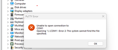

12-12-2022 02:19 PM
Im connected but getting an error in Putty.
