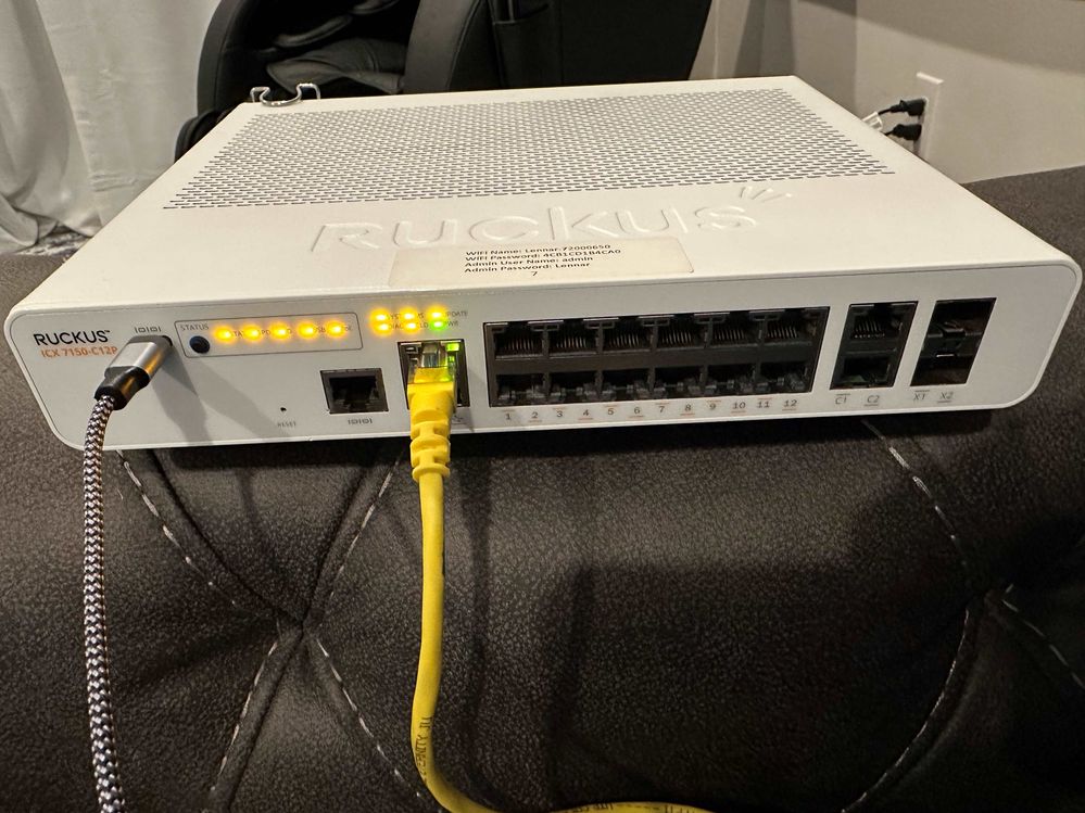

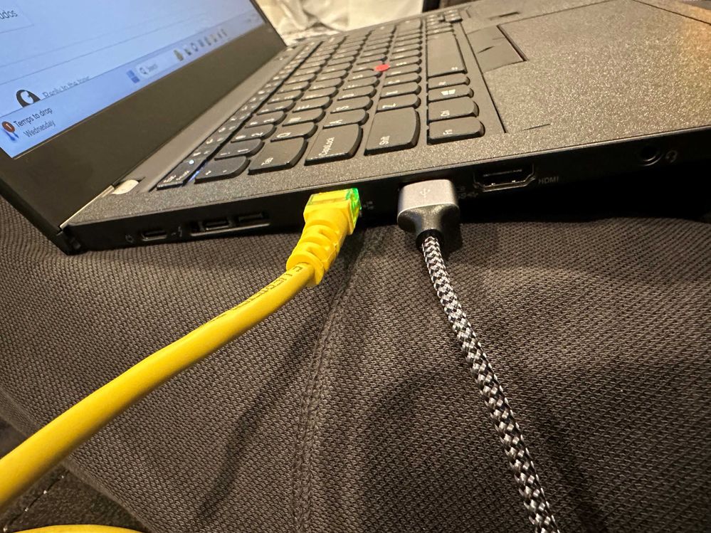

Hello Moderators.
I have Ruckus 7150 C12P when I purchased the house and am 2nd owner of this house. As previous owner disconnected all cables and wires from the switch, I try to connect and found not working. Try to reset with Pin at front of the switch and power off and on, but cannot found working. Then I try to hard reset by downloading all steps mentioned in forum. Finally found ping says not alive.
I am submit pics of the results and connections. Please guide me .
Thanks

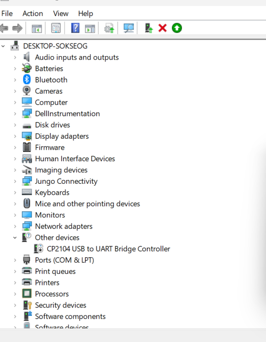

Hi @Kamal1320
Check 'Ports (COM & LPT) details (Refer to the screenshot)
If you don't see in COM & LPT details, check if you have installed the drivers of the Switch, if not please do. follow the below process.
Please make sure to download the zip drive for the file below & "extract all". Once it's extracted, run the file, the driver should be installed using the 2 links below.
Link 1: https://support.ruckuswireless.com/software/1414-brocade-ruckus-7150-usb-serial-driver-windows
Link 2: silabs.com/developers/usb-to-uart-bridge-vcp-drivers?tab=downloads
Once done, please restart the Switch and the laptop, and unplug/plug the software recovery cables.
Please check and let me know.

Hi @Kamal1320
I hope you're doing well.
Thank you for your prompt response and for providing the information.
Based on the picture you shared, it appears that the cables are correctly placed.
Even if you encounter an error, please proceed with the next set of commands following the "ping 192.168.x.x" command. If successful, the SYST and PWR indicators should turn green.
Kindly check the setup and confirm. Should you have any further questions or need additional clarification, please feel free to reach out.
Thank you once again for your patience.

11-05-2024 05:44 AM
Hello Imran.
I got new issue now as i cannot find the com port on my pc and it says when i connect the c to usb cable with box to pc. Please find picture that i find while connected.
