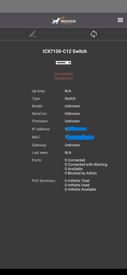

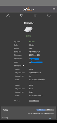

Also I tried a different solution by looking up the IP address but couldn't find it so I stopped there. When the WIFI from Ruckus was working I did take a screenshot of the APs IP address if that helps any. Please help, otherwise I will need to replace Ruckus altogether.

As I can see from the screenshots you shared, your RUCKUS ICX-7150-C12P Switch is on an older 08061a version causing this issue. (Please refer to the below screenshot)

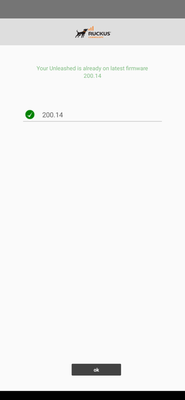

12-20-2023 04:05 PM
Hi Imran,
So I did go through and finished the update. So far it looks good. This process has been quite difficult. I really wish we could have spoke over the phone instead or something. I did run into a hiccup with the first update with the file ending in f. The file updated properly but the last step when I needed to boot it, it didn't entirely complete booting. It stopped internet access and kept giving me that PoE Fatal error again after it got to a certain point. I kept power cycling the switch and it just kept trying to boot up again then gives me the same error. My fix was by power cycling then quickly entering in the next command to copy the next update file. Doing this saved me and it finally worked out and loaded up properly. I was able to finish the updates. Hopefully I won't have anymore issues. I will let you know if I do. Is the update ending in g the most up to date one or should I update further? I just dont want anymore issues....or resolve them now when I still have some knowledge of how to do it.

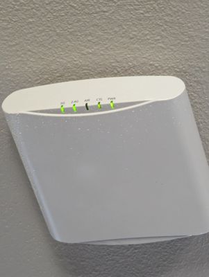

2. May I know how many Access Points are connected to the Switch? Could you please let me know the light status on the Access Points? Any of these lights are on (Please refer to the below picture and share a picture of the same)

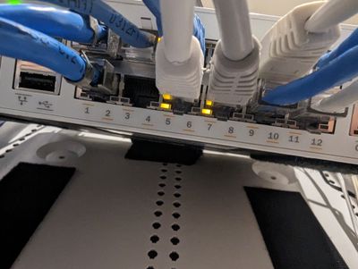

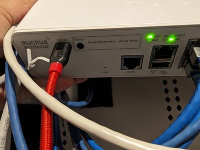

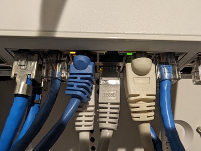

1. In the first red box, the lights in the "status box" are all off. The six lights to the right of it are all off EXCEPT SYST and PWR which are both green. In the second red box no lights or wire connections in the first 3 ports. In ports 1-12: ports with no lights (1-4 7, 10-12), there are 3 amber lights (5, 6, 8), and 1 green light in port 9. The remaining 4 ports to the right also do not have lights. only the top second to the right one has a plug in. Please see attached picture

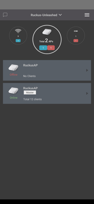

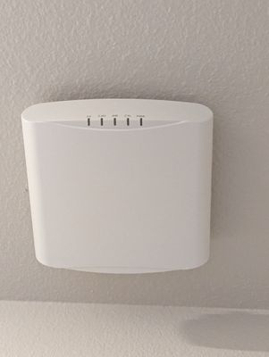

2. I have 2 access points connected to the switch. When the wifi goes off, no lights are on either. But when it is on All lights are green except AIR which is off. I have one access point on the second floor and another on the ground floor. Currently I did a power cycle and the ground floor one came back with all green lights except AIR and the second floor one is completely off. Please see the pictures below

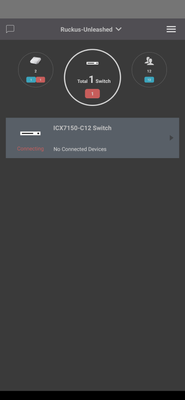

Here are additional photos of the Switch and AP units information from the Ruckus Unleash APP on my phone.

As per the pictures you shared, the light status of the RUCKUS ICX-7150-C12P and ONE Access Point seem to be in a normal state.
Could you please unplug/plug the affected Access Point’s ethernet cable from the Switch port and check if it gets power? You can plug it into any 1 in-12 ports as highlighted in the below screenshot.

I can give this a try. I am not sure how to unmount the AP from the ceiling though. I have tried to slide it off with no luck in either sides. Any ideas?
Also please note that even though it does get power to work, I am certain that they both will turn off again in a few hours, days or couple weeks. I am not sure if this fix is addressing that issue. Just last night I power cycled the switch several times and at times it worked for a couple minutes, other times it was an hour or two, but it kept turning off entirely even though the switch still had power going through. Also I am not sure why some of my pictures of the phone app show that there is no switch?
