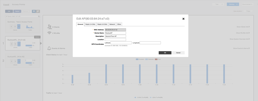

Hi Pinky, not sure if my other posts are coming through but I can't find the option to upgrade the access points, hopefully my screenshots are helpful. But the upgrade button is not available as indicated in the video instructions.
09-05-2024 03:11 PM
Hello @nfar ,
I understand that you are not getting Upgrade button to upgrade the Access points.
Could you please share the screenshot of the point where you are getting stuck.
