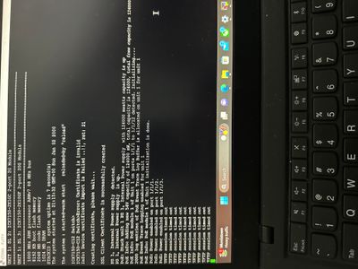

I followed the commands and got to this point and it’s starting to time out
Hi @Gregdomenicucci
This is a normal behavior when the "TFTP session timed out" message appears because the switch is looking for a TFTP server to load the configuration file from the TFTP server but there is no response from the TFTP server so for that reason creates a time-out.
You can now terminate the session and restart to check the ‘show version’ command to verify if your Switch is now on an SPS code.
Once it is confirmed, please let us know to assist you with the Upgrade of the Switch.
