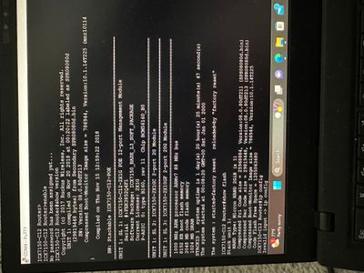

Imran,
I have spent a frustrating 6 frustrating hours over 2 days trying to get this to work or follow the instructions and still can not get this to work. Your response is unacceptable I am not an IT professional and should not have to be an expert to fix these issues. I am more knowledgeable with technology than most but this is a ridiculous ask of someone with no coding or networking background let alone a person who has no knowledge of technology or computers. Sounds like you should develop a patch to fix this issue between SPR and SPS. If you know that this model in particular is used by Lennar Homes since I’m sure you probably worked a major purchase and support deal with them then it should be a much simpler fix. I’ve downloaded 5 different programs I’ve never heard of before.
By absolute miracle after trying 3 different physical connections to the switch I get into the switch via Putty via but now what ? I entered the commands you gave me. I try to log into ruckus wireless on the app and browser and says I’m not connected to the unleashed network even though I am on both devices!

Could you please share the output of those commands if you can log in to the CLI via Putty?
Please let me know if you are stuck at any point. We are happy to help you.
