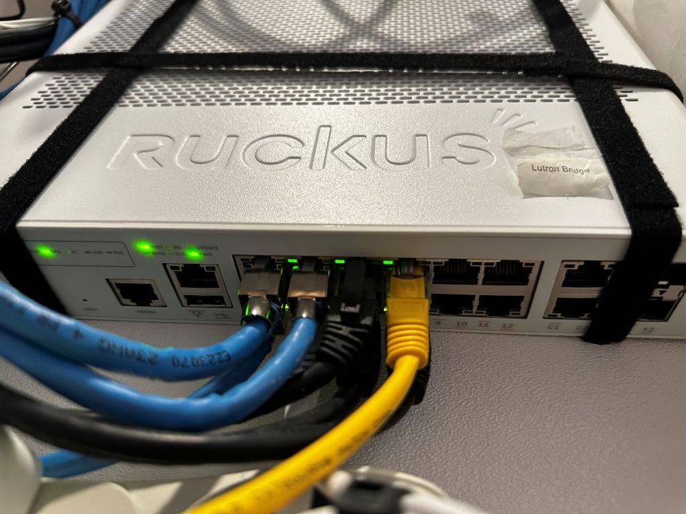

2. Please refer to the below picture and share a picture of the same, showing the light status and the FULL Switch panel cable connections to the Switch ports)

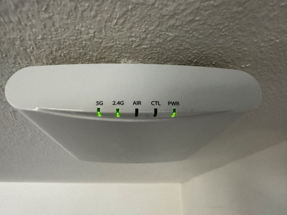

3. May I know how many Access Points are connected to the Switch? Could you please let me know the light status on the Access Points? Any of these lights are on (Please refer to the below picture and share a picture of the same)
3. May I know how many Access Points are connected to the Switch? Could you please let me know the light status on the Access Points? Any of these lights are on (Please refer to the below picture and share a picture of the same) Two access point, one on the first floor ceiling and one on the second floor ceiling.

Hello @steved1951 ,
From the response, I understand that you have 2 Access points and one of which are having all lights turned on and green including CTL and the other AP having all lights except CTL turned Green.
If there are multiple APs, only one among those APs will act as a master AP and that master AP will have their CTL turned on and green. The CTL on all other APs will be off.
