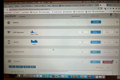

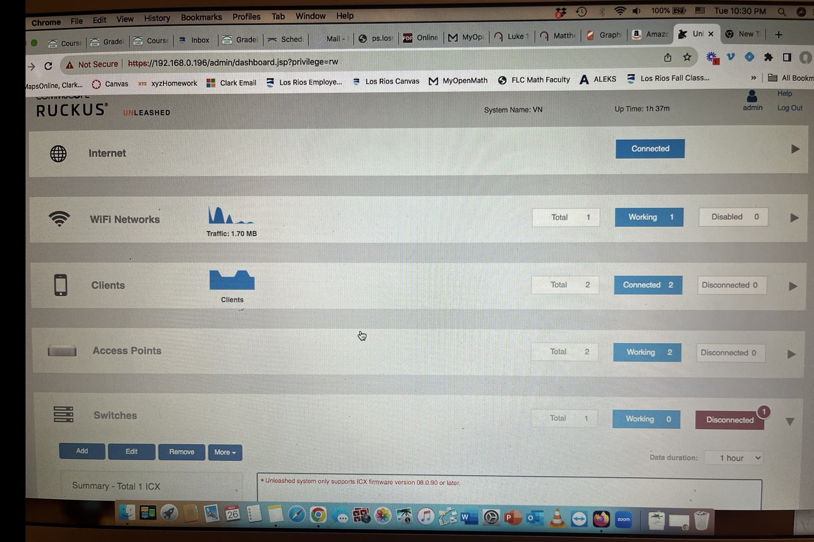

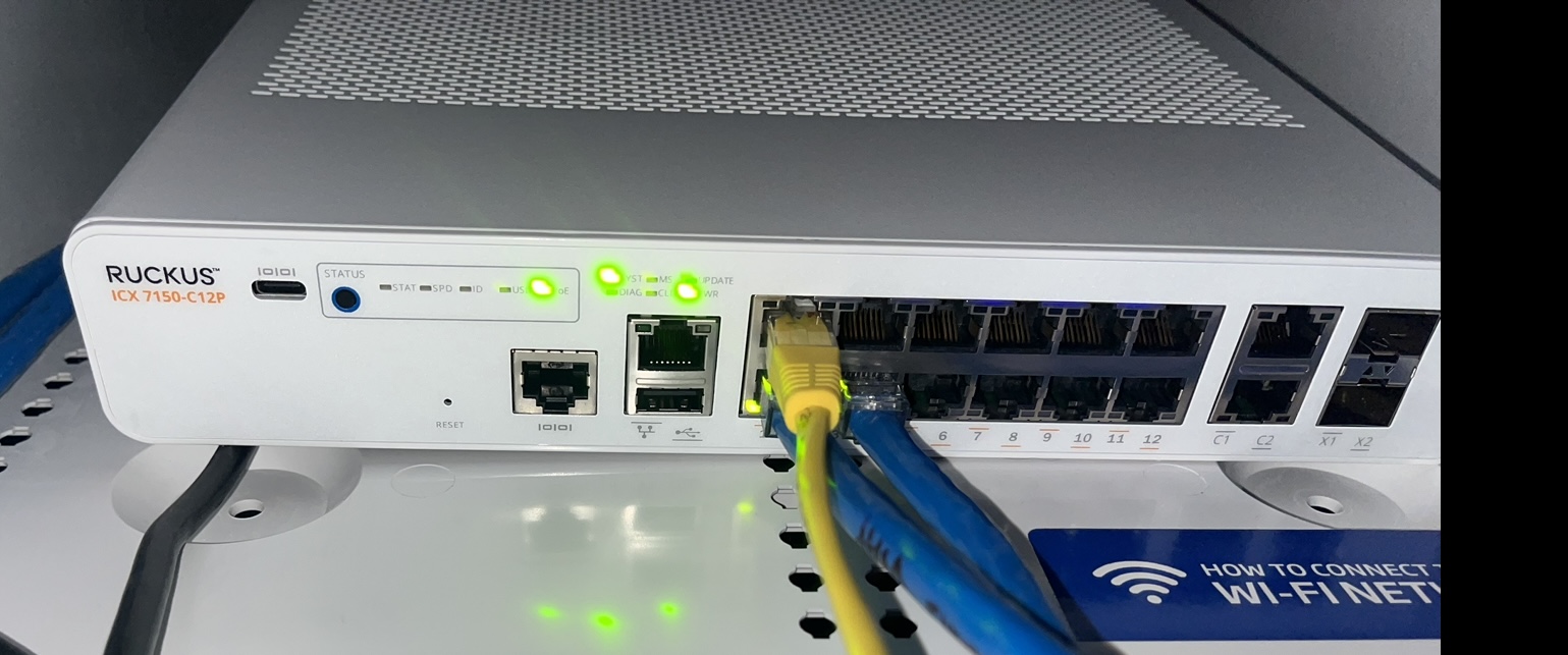

I had my internet working through access points. I had to turn ruckus switch off to put a 3 way outlet to make sure my router and modem are connected in the closet where it is installed and wires are all inside the plastic unit installed by the builder together with the switch. When I reconnected the power to the modem, router and switch, everything seems to be working as it previously, except the switch is not connected. How do I reconnect the switch so it actually sends the internet signal to the access points? Please see my setup and screen shots of what I mean when I say everything else is connected but switch is not. Thank you for your time!

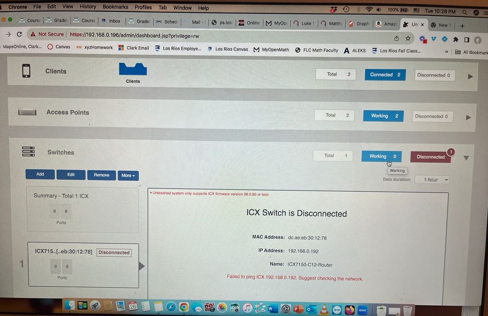

From the below screenshot you shared, I understand that the Switch is booted up on the secondary partition which is running on Routing code (SPR)
The Switch should run on the Switching code (SPS) to avoid these issues for Lennar home users. Due to a power outage/power spike, the Switch boots up on the other partition which may be running on a ‘Routing Code’ results in causing this issue.
Please follow the below RUCKUS Lennar Knowledge base self-help article which will help you to fix the issue when the Switch is running in the Routing code.
Please follow the process as explained in the article and let me know if you have any queries in this regard.

I downloaded putty and found my ip address by logging into the ruckus unleashed app via the ip address. But when I try to access the CLI via putty either through SSH or telnet it gives me the following error code: “Network error: no route to host.” and the black putty screen remains blank/black. Can you advise?
12-13-2024 12:53 AM - edited 12-13-2024 12:57 AM
Also when I use my Mac and type in the ssh [email protected] it times out and does not allow me to log into the switch. I tried the ruckus ip and it logged me in but the command line is not for the switch, it says: “welcome to ruckus, unleashed network, command, line interface”
and the following line says:
”ruckus>”
but none of the commands work (enable, show version etc. ) it says the command is either unrecognized or incomplete.
12-13-2024 01:37 AM
Update: I figured out issue about putty not working, but when I put in my switch IP address I still get error code: network error: connection times out.
