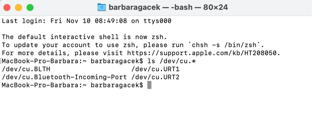

Hello, I'm following all steps but I can't find ip of my ruckus, and terminal doesn't show me command like you said Screenshot 2023-11-10 at 9.16.40 AM.pngScreenshot 2023-11-10 at 9.13.11 AM.pngScreenshot 2023-11-10 at 9.13.03 AM.png
Hi @Barb
Do you have access to your Xfinity router through either an application or a web interface? If you do, could you please verify whether you can find the IP address assigned to the ICX7150? I noticed that you attempted to use an IP scanner, but the two entries labeled "Ruckus" are likely your access points, as their MAC addresses don't match with the ICX7150.
