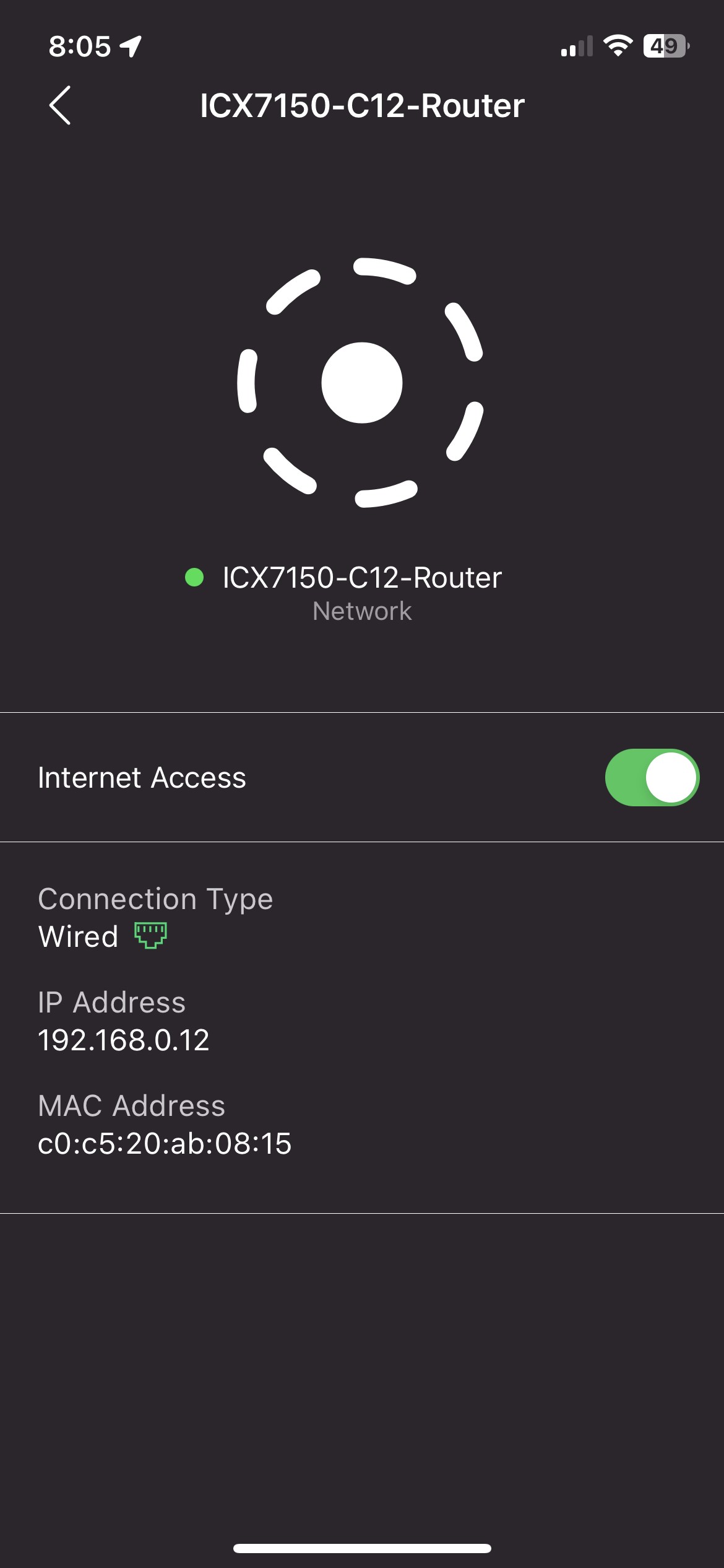

My assumption is that it booted up incorrectly as a router and needs to be changed to a switch.  However, I have read many of the other posts about similar issues and still have had no luck in resolving the issue.  I have downloaded the IP scanner and do not see the IP address for my switch, but do see IP addresses for my to WAPs.  Through my modem/router it shows me an IP address for the switch (192.168.0.12), but I am not able to access it by any means.  I have tried through the web by just typing in the IP address in the address bar and it says the connection took too long.  I have tried by using MobaXterm as well and get similar messages about not being able to connect.

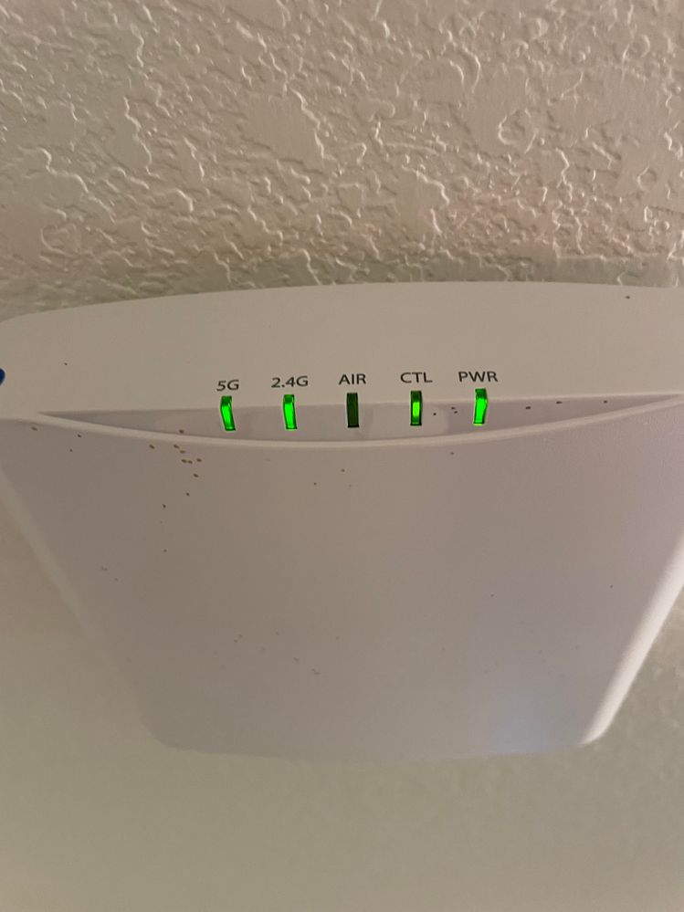

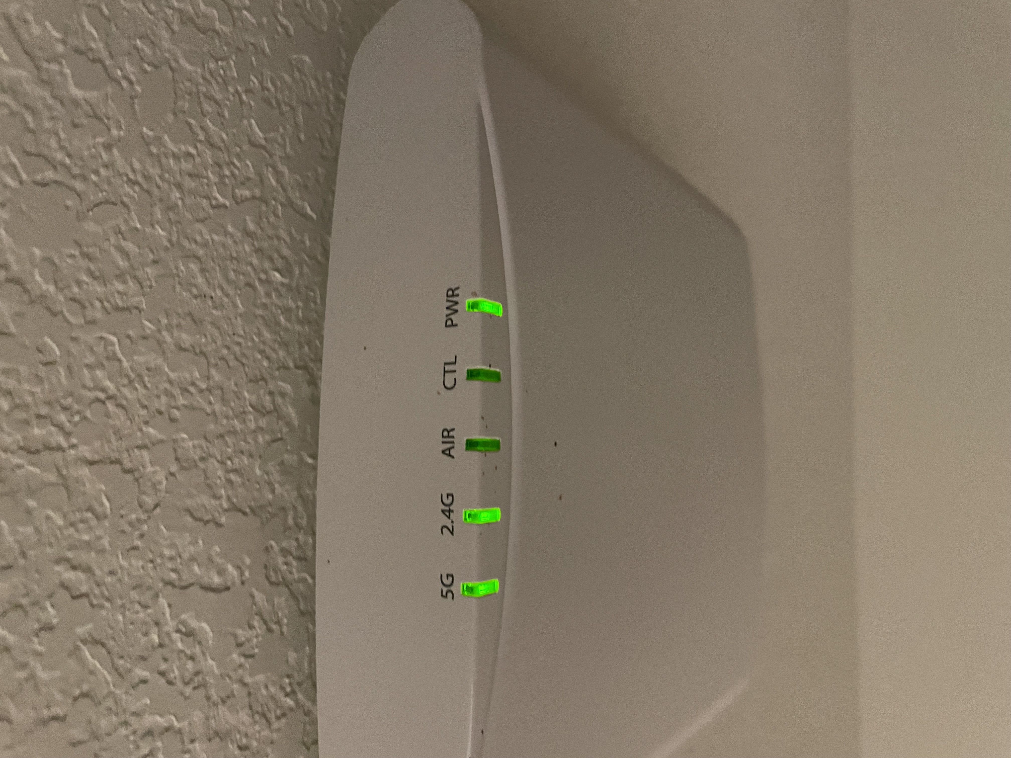

Pictures of my WAP status and a screenshot from the modem/router app showing the IP.
