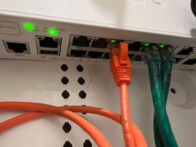

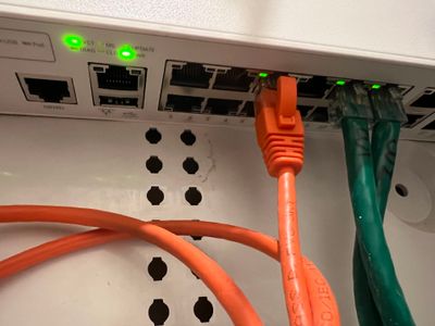

This issue is because your switch is running on the Routing code (SPR). The Switch should run on the Switching code (SPS) to avoid these issues for Lennar home users. Due to a power outage/power spike, the Switch boots up on the other partition which may be running on a โRouting Codeโ results in causing this issue.
As I can see from the output you shared, your Switch is booted up on the secondary partition which is running on Routing code (SPR) as highlighted in the below screenshot.
Please Enter the below commands in CLI to fix this issue:
copy flash flash secondary
Example:
VIDEO LINK AS REFERENCE: https://www.youtube.com/watch?v=Eem1IBgYaWc
ICX7150-24P Router#copy flash flash secondary (hit enter to accept the command and wait: until the flash finished)
ICX7150-24P Router#boot system flash secondary yes (hit enter to accept the command: the switch will reboot)
We suggest upgrading your switch to the latest stable version to avoid this issue in the future. Your Switch is on an older version that is 08080d. Please let us know once you complete the above process to assist you with the Upgrade of the Switch.

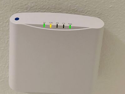

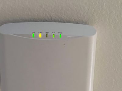

โ09-06-2023 08:57 AM
Seems like itโs stable. In the morning when I looked at RUCKUS upstairs it showed all red lights but now it doesnโt.
Thank you for all you timely response and guidance to resolve the issue.
