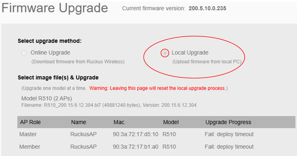

I am using the the Local upgrade option using the .bl7 file - see the screenshot. It shows the grayed out button selected for local.

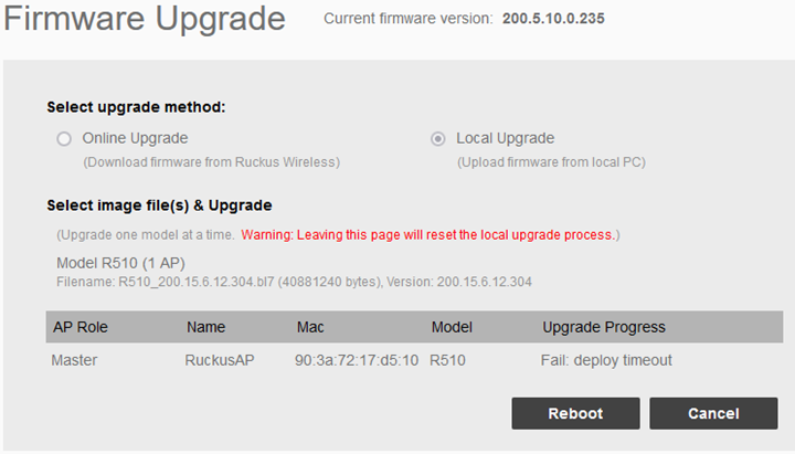

Just to let you know that I took these additional steps today with no change. I physically removed the Member AP from the Switch leaving only the Master. Then I factory reset the AP 2 times. I went through the process of accessing the Connect.me-xxxxx WiFi and went through the Set-up Wizard. I accomplished this two times and got the same result. See the screenshot attached trying to upgrade just the Master.
It's obvious to me that for whatever reason, these R510s are not processing/flashing the code fast enough before the system times out. It takes about 3 minutes for the process to go from 0-99% then in fails.
