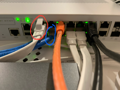

The white cable circled in red below is from the router. The blue cable circled in blue below is the master A.P. (working). The orange cable is currently plugged into the A.P. that does not work.

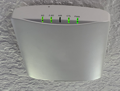

Working A.P.:

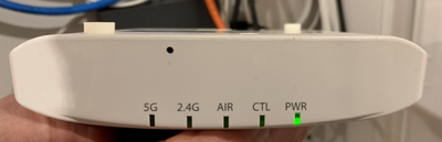

A.P. that doesn't work (flashing CTL light):

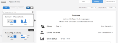

The working A.P. is the Master as shown below.
