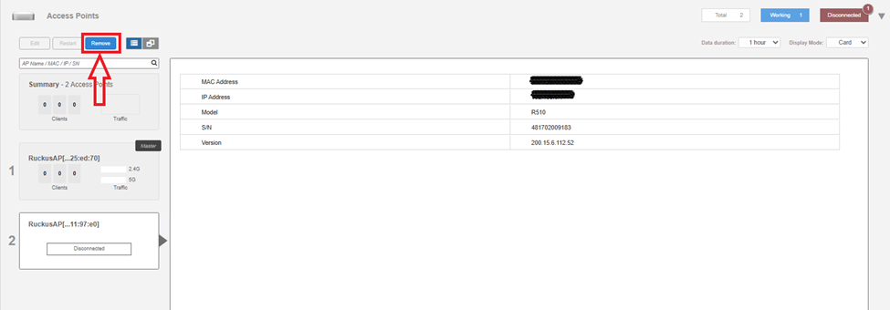

From the response shared, I understand that one of the Access points are in the disconnected state and is having flashing CTL light.
I would request you to please disconnect the ethernet cable from the affected AP and the Switch.
Once after disconnecting the cable from the Switch, please remove the disconnected AP from the Unleashed website as shown in the below figure:
Please wait for a while and connect the AP cable back to the Switch.
Please check if the AP is getting connected in the Unleashed website.
I tried the above, waited about 20 minutes, reconnected and have the same results with the flashing CTL light.  The A.P. does not show up on the web interface.

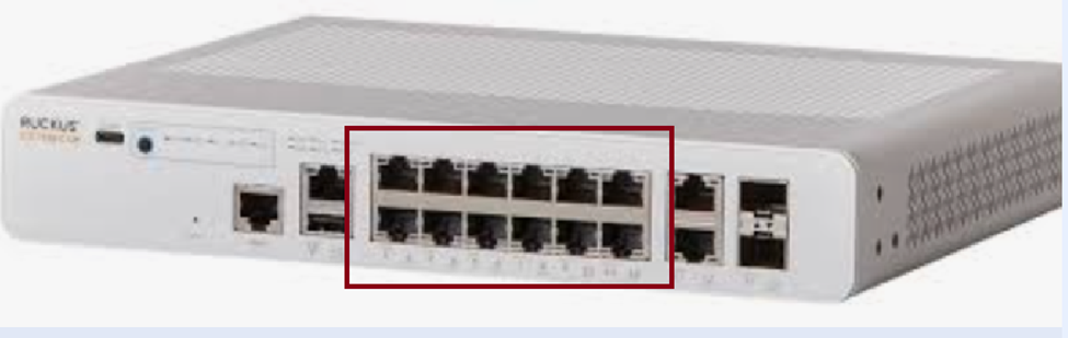

Please help us with pictures of your ICX-7150-C12P Switch showing the cable connections to the Switch ports.
Also, please share the light status on Access points.
Please llet us know if you have any queries in this regard.
