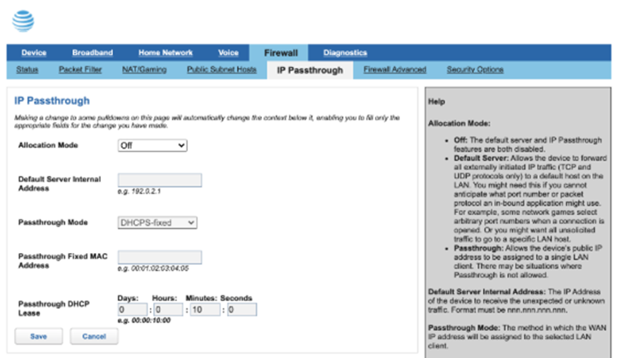

Getting ATT device to hand off WAN IP info to R650.
1. ATT WBS320-500 is in "IP Passthrough" mode
2. "IP Passthrough" ask for WAN MAC address of the R650 (Port1) and it see it from the pull down option.
3. R650 is in GATEWAY mode / DHCP. Waiting to receive WAN IP from ATT.
4. WAN Port1 on R650 goes to one one the Yellow ports on the WBS320-500.
5. LAN POE Port 2 on R650 goes into one of the POE+ ports on the Netgear swtich.

I understand that the IP pass through is enabled for your ATT WBS320-500 device.
I would request you to please disable the IP pass through on your ATT device.
To disable the IP pass through, you’ll need to log into the ATT WBS320-500’s admin interface and turn off or uncheck the IP Passthrough option, under Firewall.
This will stop it from forwarding the WAN IP directly to the R650.
After disabling, make sure to reboot the ATT device and the R650 so they can renegotiate their IP assignments properly.
