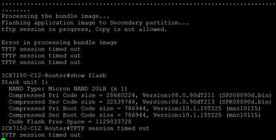

I was finally able to login to the switch/router.  I see that it is running router code which is in the secondary flash.  I tried the command "copy flash flash secondary" but I get the following error.
I receive the same "TFTP session in progress. Copy is not allowed." when trying to copy the updated SPS08095gufi.bin file to flash to upgrade from the current 08090d.  Any idea how I can force the TFTP session to stop so we can copy to flash?
