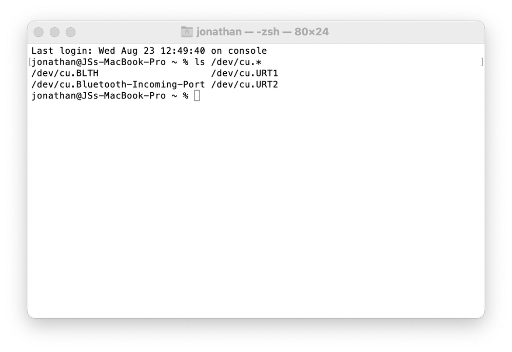

We seem to be going around in circles a bit here. I had already installed those drivers before your last response. However, in an effort to try to resolve this I have uninstalled them, upgraded my Mac to the latest version of Mac OS X which is Ventura and then followed your instructions again.
I installed the v6.0.2 software in your last response but no additional files appear in the list of /dev/cu.* after doing so. The only entries in there are these:
However, these entries were present before I installed the SiLabs software. Any idea why I'm not seeing the new device?
Jonathan
Valued Contributor III
Hi @golfmad
Thanks for your response.
Please try using another cable because sometimes the cables you might be using one with only power connections, not data.
