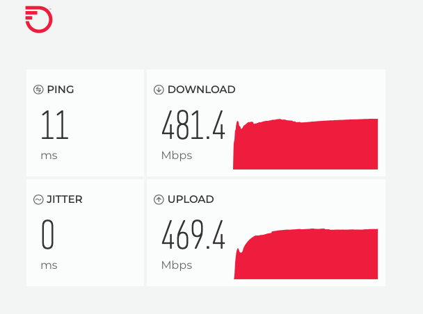

I use a physical hardwired connection direct from the ISP router to my office so here's the speedtest results from my laptop over the direct connection.
