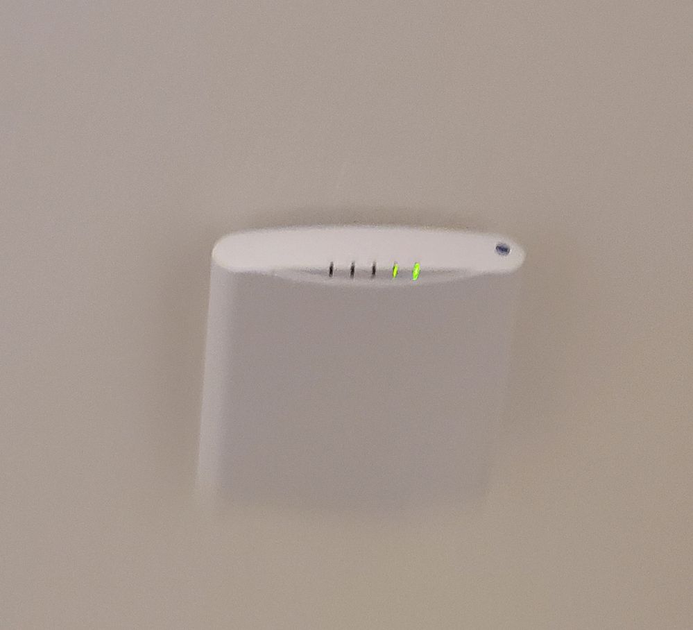

I am unable to connect to my Ruckas AP as of today. Everything has been working fine for a long time.
I am able to connect directly to my Cox modem both hard wired and wirelessly.
After a number of reboots and restarts, I'm getting the same results. The 4 lights on my AP are solid green.
When I try to connect to my Lennar network wirelessly, I either get "connection failed" or "connected without internet"
Here are photos of my switch and AP.
Any suggestions on how to get things working again are much appreciated.
Thanks,

02-06-2026 08:03 PM
Pinky,
Thank for your support.
I have reset the AP according to the instructions. Actually, I have done it atleast 3 times.
I have been able to get it to show a new wireless network of Configure.Me-XXXXXX
Then when I go to the Ruckus Unleashed App on my mobile phone, I am not able to complete the setup.
After the reboot, only 2 of the 4 lights are lighting up on the AP unit.
Also, when I connect to the Configure.Me-XXXX wireless network using my mobile device, I get "Connected without internet/ Not secured"
It appears to me that the factory reset was not completely successful.
Please advise any recommendations that you have.
Thank you, Ron
