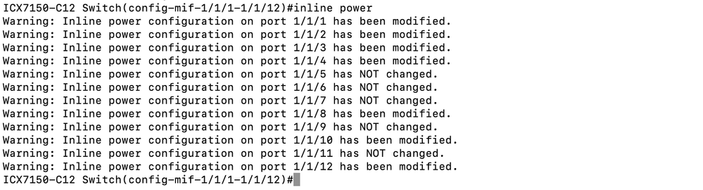

Hi Jayavidhya,
Here is the following results after performing the commands, please advise how to proceed
Mel27
Mel27

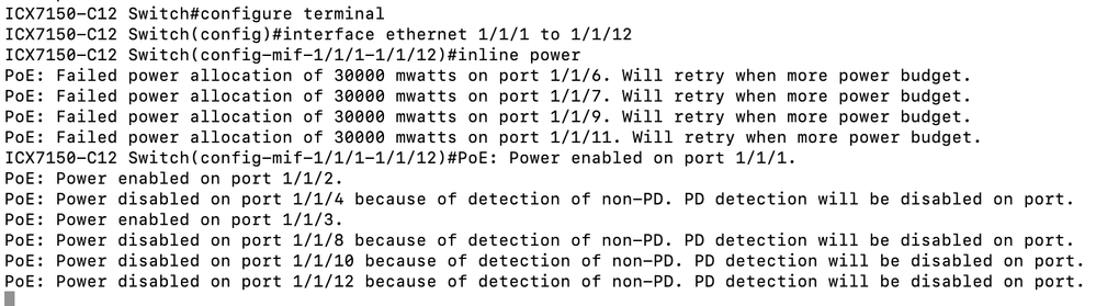

Mel27
I ran it again and got the following, now I see the network, thank you!!
