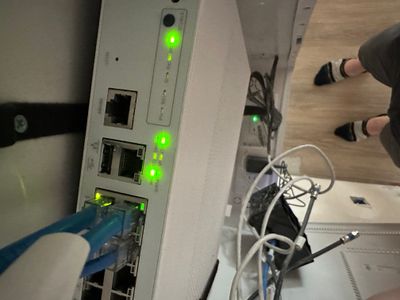

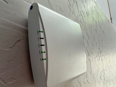

I have 2 access points. These are pics of my switch and points. No amber lights and looks normal but definitely not functioning normal. I also can’t get access to my ruckus app

Hello @Pewbert1 ,
Thank you for sharing the pictures .
We need to check few configurations on the Switch to assist you further.
