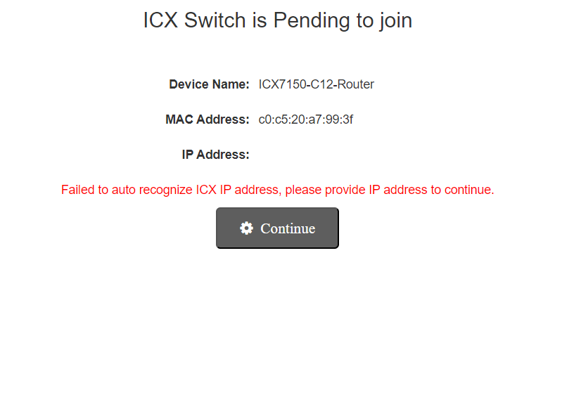

I am trying to factory reset my switch because my ruckus site does not show the switch as being connected and cannot find the actual switch IP address.
I have tried using all the different password combinations and am consistently getting this, and am unable to enter the command prompt to type enable. Switch keep asking for a ussername and password when I console in and do the boot > no password command and after it runs.
I just want to start an RMA to get a new switch as this point as this has been affecting my work and all.

DMA pool size: 134217728
PHY Reset De-asserted
sw_pp_sdk_init:136 ToR init
SOC unit 0 attached to PCI device BCM56160_B0
Firmware version from File: 2.1.1
Pre Parsing Config Data ...
Done with Pre-allocating nexthop id's for Unicast & Openflow
Warning: This operation would close all existing SSH connection.
Error! 1/3/1 speed is 1G. A stack-port needs at least 10G speed.
Error! 1/3/2 speed is 1G. A stack-port needs at least 10G speed.
Invalid input ->address 192.168.1.249 255.255.255.0 dynamic
Type ? for a list
Invalid input ->default-gateway 192.168.1.1 dynamic
Type ? for a list
Going to sleep forever...
Error in opening /fast_iron/.images/secondary.ufi
fopen: No such file or directory
Successfully notified stack role 'none' to hmond
System initialization completed...console going online.
UNIT 1: compiled on Sep 23 2019 at 00:00:25 labeled as SPR08090d
(32539748 bytes) from Secondary SPR08090d.bin (Non-UFI)
SW: Version 08.0.90dT213
Compressed Secondary Boot Code size = 786944, Version:10.1.15T225 (mnz1011 5)
Compiled on Thu Jan 31 07:08:55 2019
HW: Stackable ICX7150-C12-POE
Serial #:FEK3826R08X
Software Package: ICX7150_BASE_L3_SOFT_PACKAGE
Current License: 2X1G
8192 KB boot flash memory
2048 MB code flash memory
1024 MB DRAM
STACKID 1 system uptime is 9 second(s)
The system started at 00:04:45 GMT+00 Sat Jan 01 2000
The system : started=cold start
=============== WARNING: FI image is not booted from UFI!!! ========= ======
====== Please download UFI image and reboot the system for full functionality ======
Press Enter key to login
Creating certificate, please wait...
SSL Client Certificate is successfully created
PS 1, Internal Power supply detected.
PS 1, Internal Power supply is up.
PoE: Stack unit 1 PS 1, Internal Power supply with 124000 mwatts capacity is up
PoE Info: Adding new 54V capacity of 124000 mW, total capacity is 124000, total free capacity is 124000
PoE Info: PoE module 1 of Unit 1 on ports 1/1/1 to 1/1/12 detected. Initializing ....
2000 log entries of PoE Event Trace Log Buffer is allocated on unit 1 for unit 1
PoE Event Trace Logging enabled for unit 1
PoE Info: PoE module 1 of Unit 1 initialization is done.
PoE: Power enabled on port 1/1/9.
PoE: Power enabled on port 1/1/11.
TFTP session timed out
User Access Verification
Please Enter Login Name: TFTP session timed out
Please Enter Password:
User login failure.
Please Enter Login Name: admin
Please Enter Password: TFTP session timed out
User login failure.
show version
Please Enter Login Name: super
User login failure.
admin
User login failure.
User login failure.
User login failure.
User login failure.
User login failure.
User login failure.
User login failure.
User login failure.
User login failure.
User login failure.
User login failure.
User login failure.
User login failure.
User login failure.
User login failure.
Please Enter Login Name: enable
08-29-2024 05:51 AM
Hi @flyguy22
Based on the information provided, it appears that you are encountering an issue when trying to reset the username/password of the RUCKUS ICX-7150-C12P Switch with a Routing code issue.
Please try to follow the below video and process and let me know if that works.
I would request you to please refer to the below Youtube video in recovering the Switch password.
https://www.youtube.com/watch?v=0ynKwSTpd_A
Once you recovered the Switch password, edit the current or create a new password and username by using the below commands:
configure terminal
device(config)# username super password pass
Where the username is ’super’ and password ‘pass’
In order to allow the correct authentication please run the following commands:
Device(config)#crypto key generate rsa
device(config)#aaa authentication login default local
device(config)#aaa authentication web-server default local
Now you could try using your new credentials to log in on CLI. (If new credentials do not work, please wait for some time and try again later)
If that doesn't work, could you please let me know if you have an IP address for the Switch?
Please follow the above process and let us know if you have any queries in this regard.
08-29-2024 07:29 AM
that doesn't help me. I'm getting the user access verification AFTER i try to recover. so I did the no password and boot but then it is still asking me for the user access verification.
I do not have an IP for the switch. Only my wireless access points (I have 2 of them) and nothing else shows on the site.
From all other research I've done on this, it seems as if the switch needs to be RMA'd.
08-29-2024 10:58 AM
Hi @flyguy22
When prompted with "Enter 'b' to stop at boot monitor: 0," please ensure you press 'b' within 2-3 seconds.
Additionally, follow the steps outlined in the video provided:
Please confirm once you have completed these steps and let me know if you if it works.
08-29-2024 11:36 AM
I followed all those steps and i still am getting asked to enter user access verification. I followed the YouTube video and all the guides again
i still cannot get past the user verification access prompt to type the command prompt, enable
