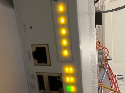

My Ruckus Access point is dead after a power outage no power is coming on. Since now this community thread is the new support model for Lennar Ruckus customers, how can I get it fixed now? This is very frustrating and I’m not tech savy.
15 REPLIES 15
This is what is going on so far still no power to access points on ceiling even though ruckus is plugged in and powered on

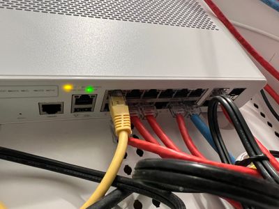

Hi @Smara5
Thanks for the details provided.
Basically if the switch has one green and one yellow light, it means that the switch is stuck in boot mode.
  1. Remove power from the switch.
If this step doesn't work, we need to perform a software recovery.
Here is the quick guide to perform software recovery.
Note: after fixing the issue of the Switch been stuck in boot mode, please perform an upgrade to the code 08095g UFI and upgrade both partitions with the switching code file named SPS08095gufi.bin, so perform the software recovery using the code 08090k with the upgrade image file named SPS08090k.bin, then when the switch is back to normal upgrade to the file SPS08095gufi.bin for both partitions primary and secondary.

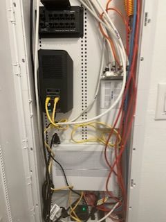

How long does it take after I do the reset the lights continue to blink. They are not solid. It’s been over an hour. What do I need to do??
Valued Contributor III
Hi @Smara5
Thanks for your reply.
If the reset process doesn't work, we need to perform a software recovery.
Here I attach the quick guide to perform software recovery.
