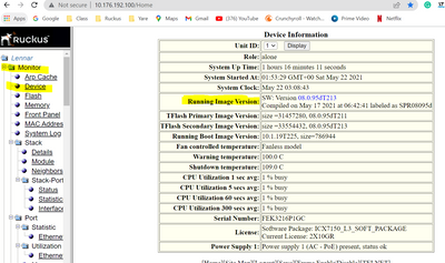

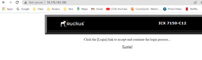

Can you gain accesses to the Switch IP address that may be displayed in the Unleashed dashboard, if that is the case, access and provide the next information from there?
While your computer or phone is connected to the Unleashed network, search the IP address of your Switch>open a browser and paste the Switch IP address Monitor>Device
Note: you can use the next guide to find the Switch IP address:
If the next are your Symptoms, seems the Switch started booting from the incorrect partition after the power outage, let me add the Guide to solve the issue, please read the guides carefully before start the troubleshooting.
