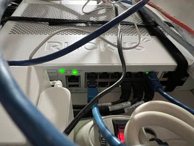

Our power went out just where all of our modem and the other 80 things probably plugged into it and now the wireless access point has no lights on and everything that was connected to that now has no internet and is not working. I’ve looked through similar questions and tried to follow those steps. Nothing seems to work.
Long story short I need help we are stumped. Is there too much plugged in? I just want to fix it and it’s hard to get an answer.

Never been unplugged it’s still plugged into how they set it up. Trying to attach a picture I see both green and amber
Hi  @Kpeck
Seems that you switch may present some PoE issue (power over Ethernet)
To solve this you must access the command line of the Switch and do some diagnostics
