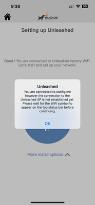

It is now reset.
Should I connect the other APs prior to configuring the network ? Or set up the network and then connect the other APs?
Samrat
IMG_5045.pngPlease advise
