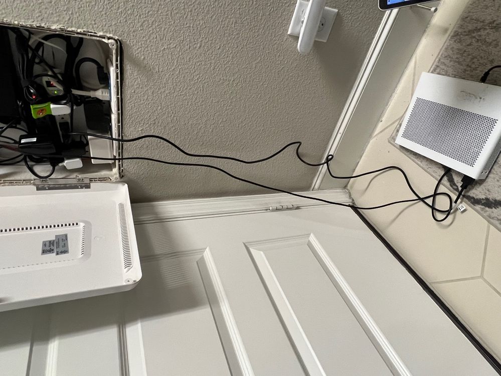

The power went out due to a storm at my home. Once the power came on the WAP had no lights on it. The brain for the WAP has power and a green and a yellow light on it. Can someone tell me what the issue maybe and how to fix it? thank you

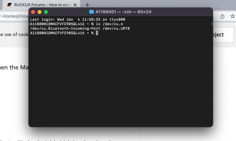

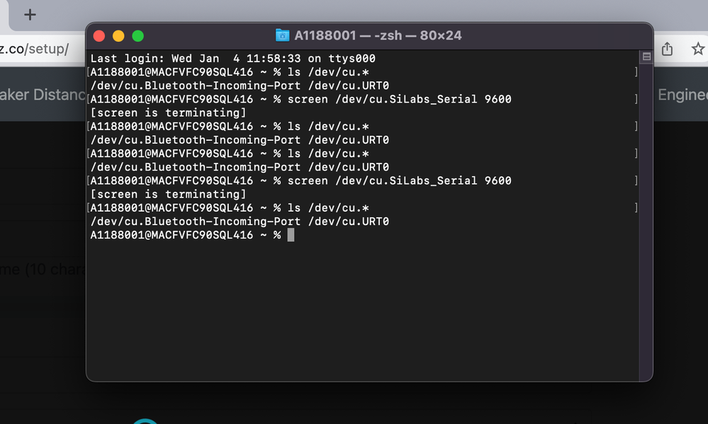

Please provided us a picture/ photo when you are trying to access console with the console cables on switch ICX-7150 - C12P and PC connected.
What error were you getting when trying to access the console, you can send it here:
Like below :

On behalf of Mr.Patel im writing this, im a IT tech for BestBuy I have tried to trouble shoot this device for him and get the info you are asking of him we do not have the connect cable for the console we tried a usb to usb c no response from the console, but upon hard reseting the device thru the pin hole we are still unable to pull a IP address to access the web GUI upon further investigation I noticed the lights on the front of the switch were flickering randomly and as some point even completely turning off and back on if this is not enough to get a RMA then im sure Mr.Patel and anyone on my team would love to have you team view into the clients PC and help us trouble shoot the issue
