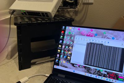

 So I removed all the cables from the switch, did a factory reset on the APs and the switch, and then tried the commands and got the same message repeating over and over. See image below
