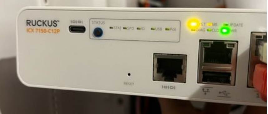

I noticed no internet and no light on my access points. Then i've check my Lennar SW/WLC displayed an amber light only to power cycle several times with no success of restoring the APs.
here is the pic of the amber light.

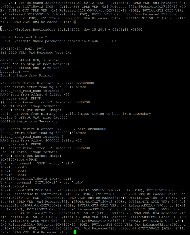

I've consoled into my ruckus ICX and this is what i see...even after trying to reset to default.
It's time for an RMA. The router hangs and does not respond to any keystrokes and is pretty useless.

As per the case description, I understand that your ICX-7150-C12P Switch has a Amber light on it.
Please follow the below Lennar Self help guide link which may help you get this issue resolved.
Please follow the guide and process once again. Let me know if you are stuck or need assistance at any step.

Hi Imran,
I'm well but could be doing better. i've already upgraded and loaded the UFI 08095F and then 08095G. However, the during the upgrade i've delete the flash and the running configuration. So the image i've used was SPR08095gufi.bin and there is no default configuration at. So, is there default configuration you could send me for the lennar sw. I know i've installed the router image...so maybe a config for the SPR vs SPS?
let me know how to move forward.
