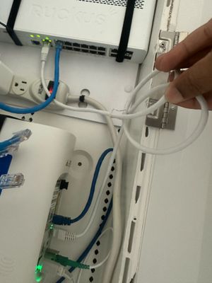

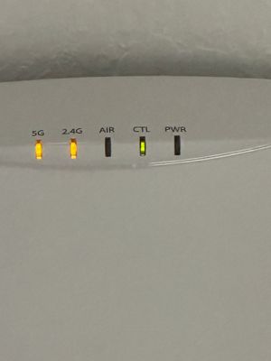

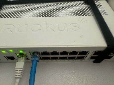

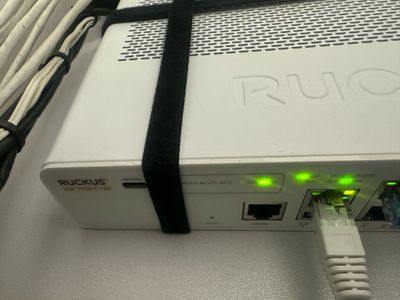

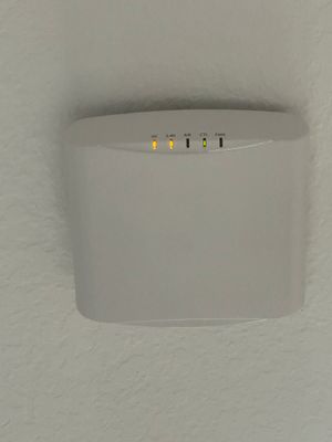

Here are the pictures you have requested

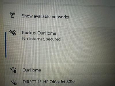

We would request you to please share a screenshot of the error while you connect to the newly created SSID.
-- on the mobile, the WIFI connection when connecting to the SSID (Ruckus-OurHOme) is spinning for a while and then connect and no internet.
-- on the PC, it takes 30 seconds to connect and shows no internet
Hello @ParklandUser ,
From the pictures you shared, it seems like one of the ethernet cables is plugged into the wrong port on the Switch panel. It must be plugged into any 1 in-12 ports as shown in the below screenshot. Please unplug the ethernet cable and plug it into the correct port then reboot (unplug and plug from the power outlet) and try to connect to the Internet via Access Points.
It should be plugged into one of the 12 ports as shown in the below screenshot.
That worked. I thought only the AP cable needs to be in the 1 - 12 ports, didn't realize the ISP cable also. THanks for the help. TO add other APs, should I just plug them in in the 1 - 12 ports? NO other mesh configuration right? these are hard wired.
