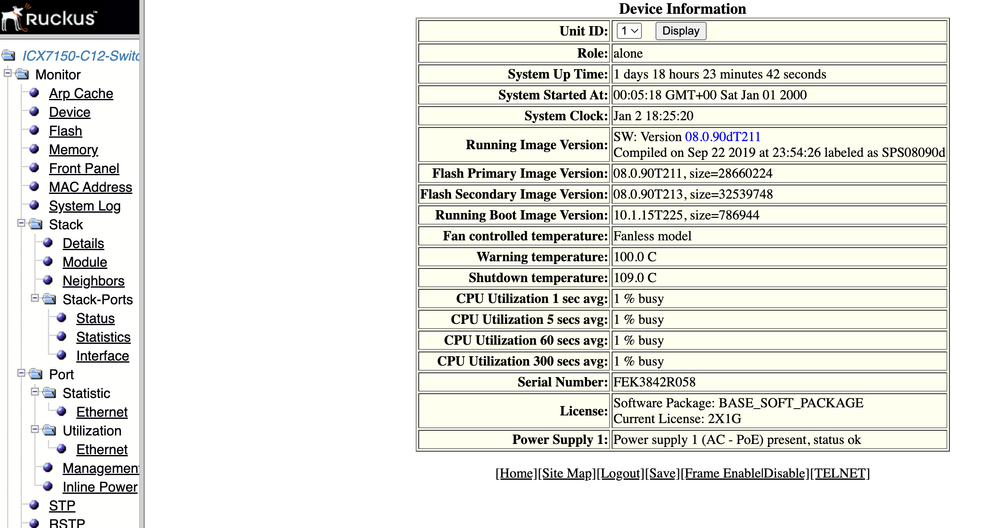

Once you access the GUI of the Switch, I would request you to please share the screenshot of the running version of the Switch for us to assist you further.

Hi Pinky. Yes, i can access the switch via its IP. Here's a screenshot of the device info. It's setting up some sort of FTP or TFTP to get the new version on the switch that seems to be the problem. I do not have access to a Windows laptop.

I understand that the version on the Switch is 08.0.90d.
We recommend transitioning to version 08.0.95g, identified as the stable version for Lennar Home users.
To facilitate this transition, we have recently introduced an upgrade tool tailored to ensure a seamless process. Utilizing this tool is straightforward: users simply need to input the IP Address, Username, and password associated with the Switch into the software interface.
