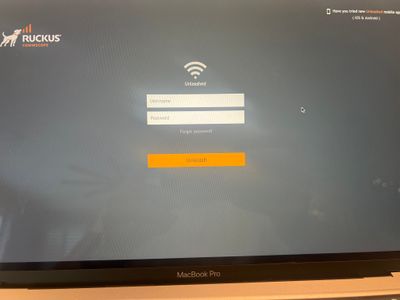

I’m logged in

My switch was showing disconnected due to no IP address. I entered the “ruckus-unleashed” IP address as found on my xfinty portal. Has been stuck on “ICX switch is connecting” for the last 20 minutes.
There is a another IP adresss I tried entering related to “ICX7150-C12-Router” as also found on xfinity portal. That IP address notified me invalid rather or could not find/ping.
