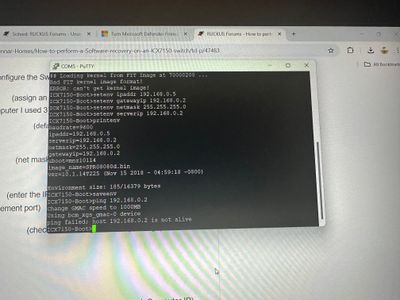

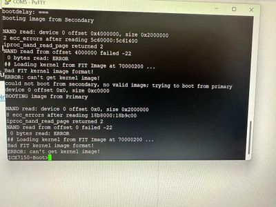

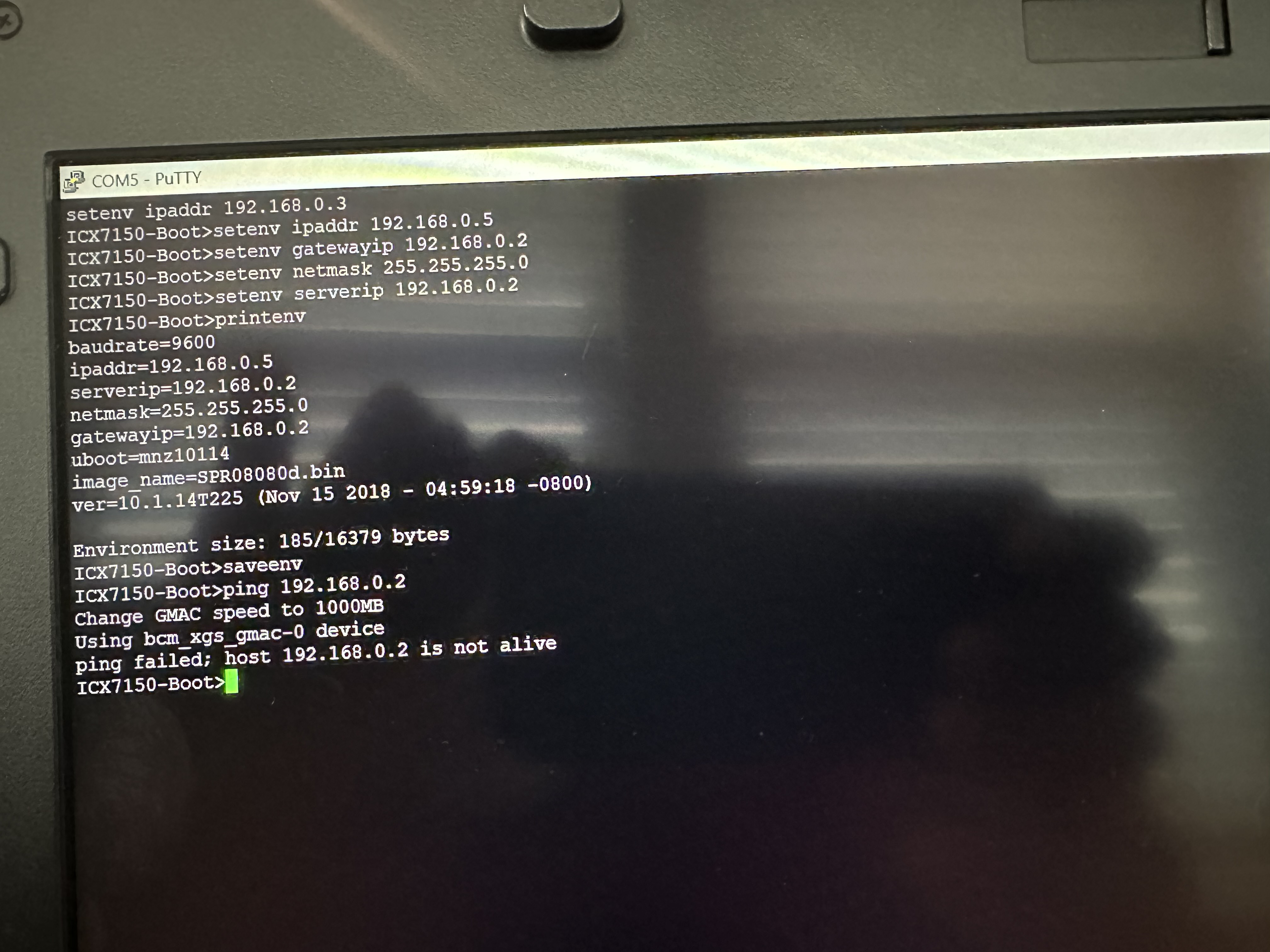

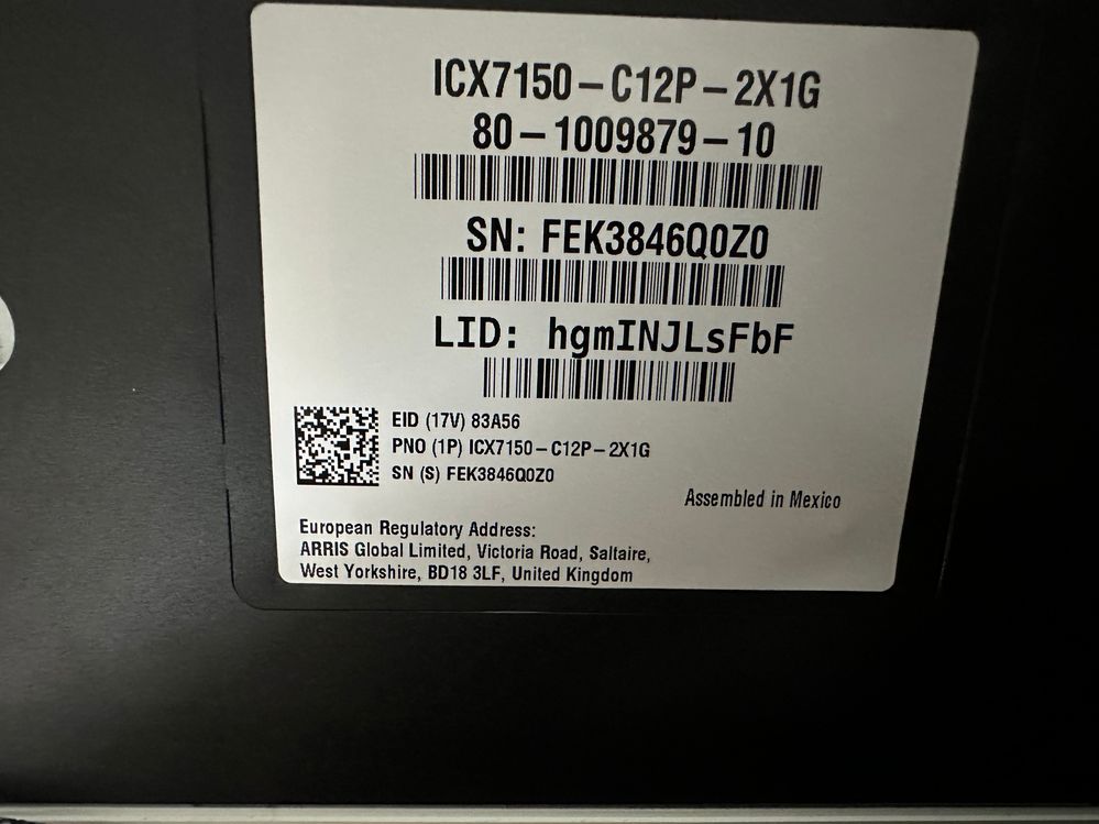

I have Ruckus 7150 C12P when I purchased the house and am 2nd owner of this house. As previous owner disconnected all cables and wires from the switch, I try to connect and found not working. Try to reset with Pin at front of the switch and power off and on, but cannot found working. Then I try to hard reset by downloading all steps mentioned in forum. Finally found ping says not alive.
I am submit pics of the results and connections. Please guide me .

Hi @Kamal1320
Based on the information provided, it appears that you are getting a ‘not live’ error during the RUCKUS ICX-7150-C12P Switch Software Recovery process.
This error is usually due to a firewall that is enabled on your Windows laptop.
Please refer to the below RUCKUS Lennar Knowledge Base self-help article to fix this issue.
Additionally, please make sure to use ethernet cable (both ends RJ45 plugs) and USB to type C cable both together as described in steps 2 & 3 in the guide link. (Refer to the below screenshots)

Thanks Imran.
I did the window's firewall off as described by your tech Jaya in some thread. It says same not alive". I am posting 2 pics after firewall off.

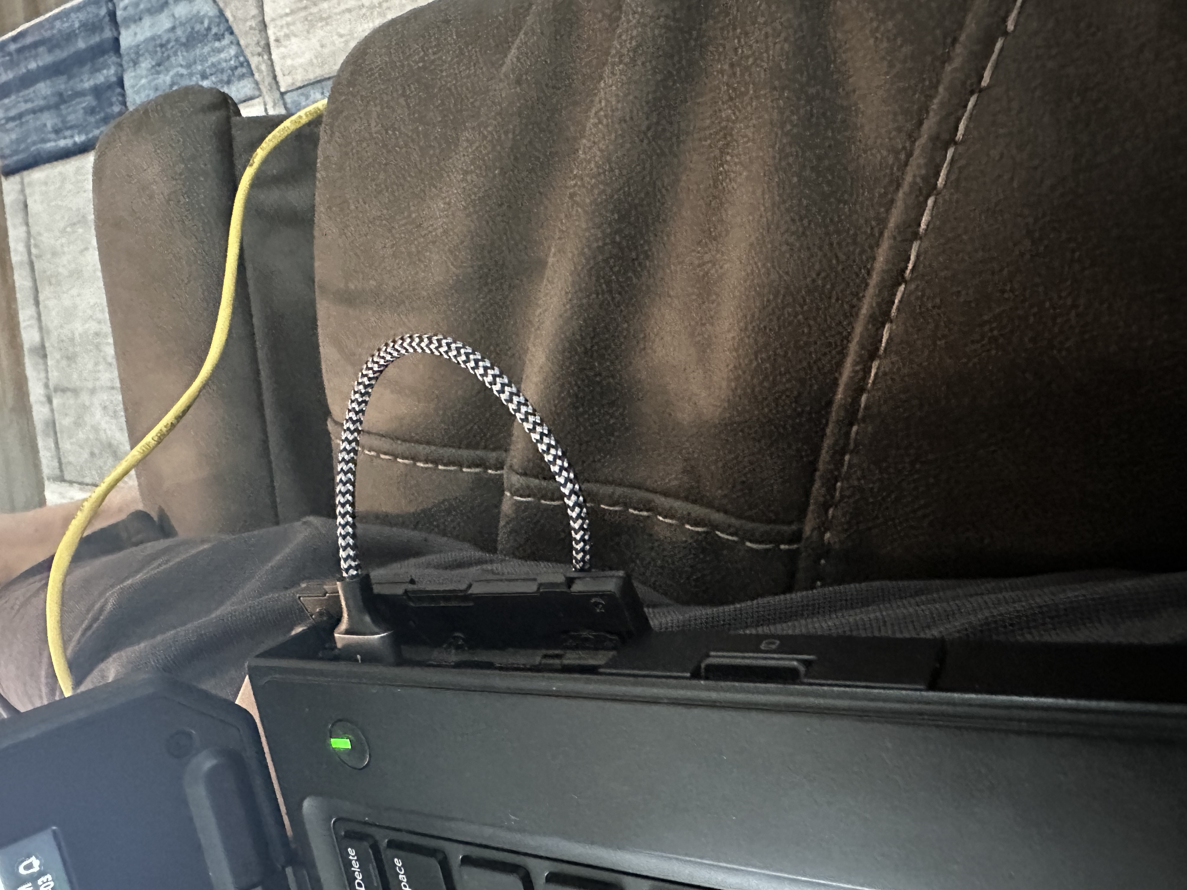

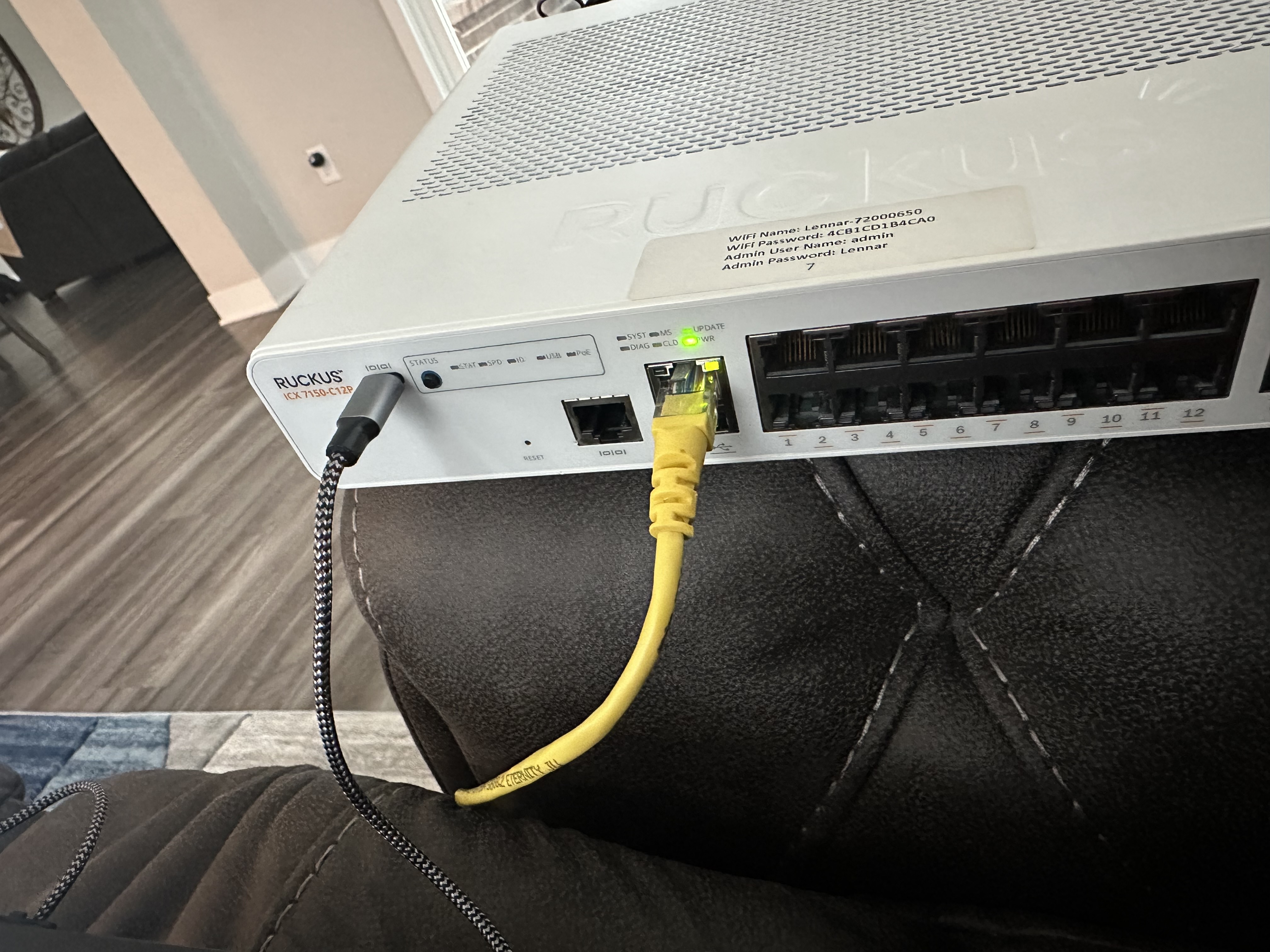

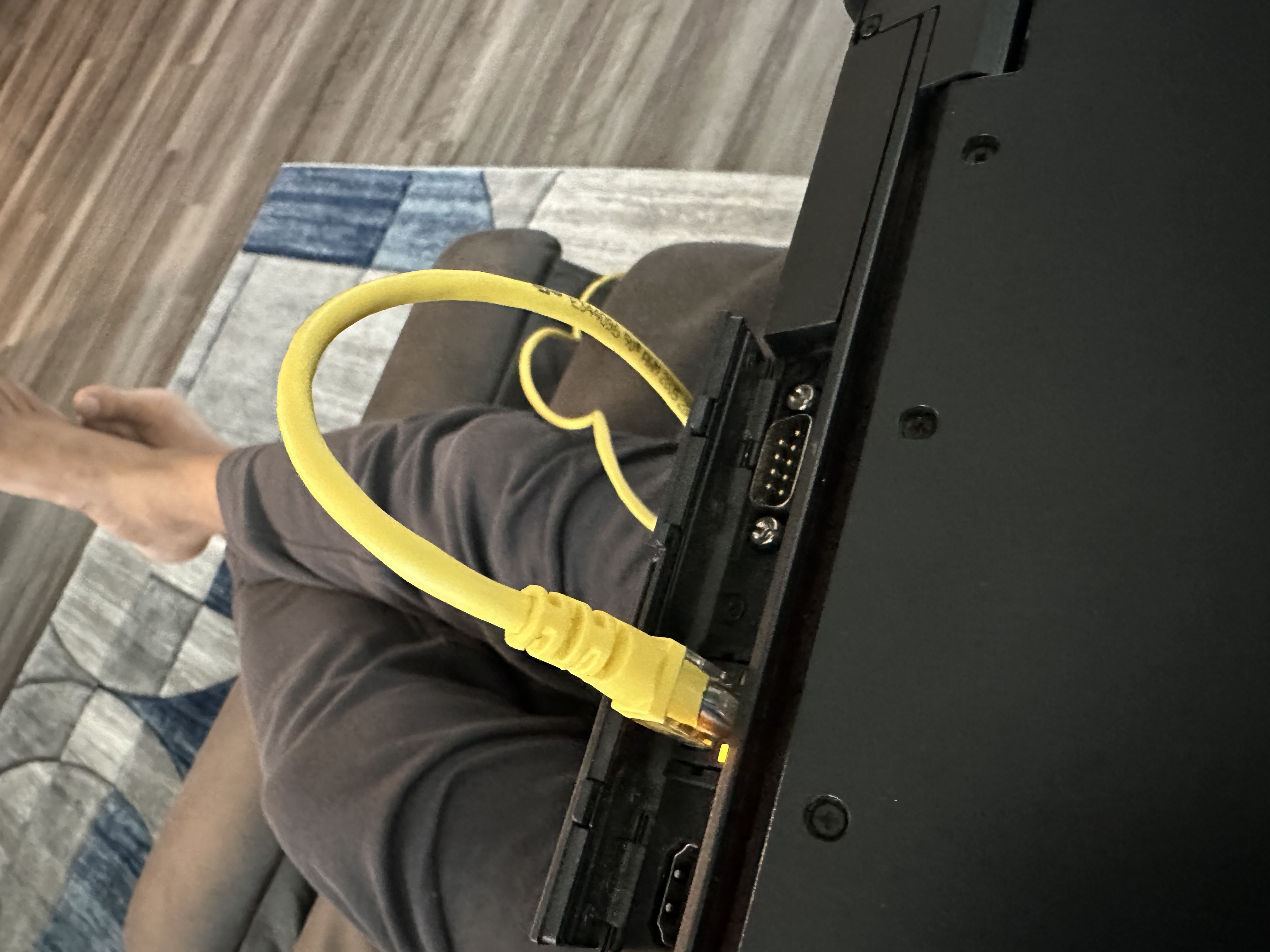

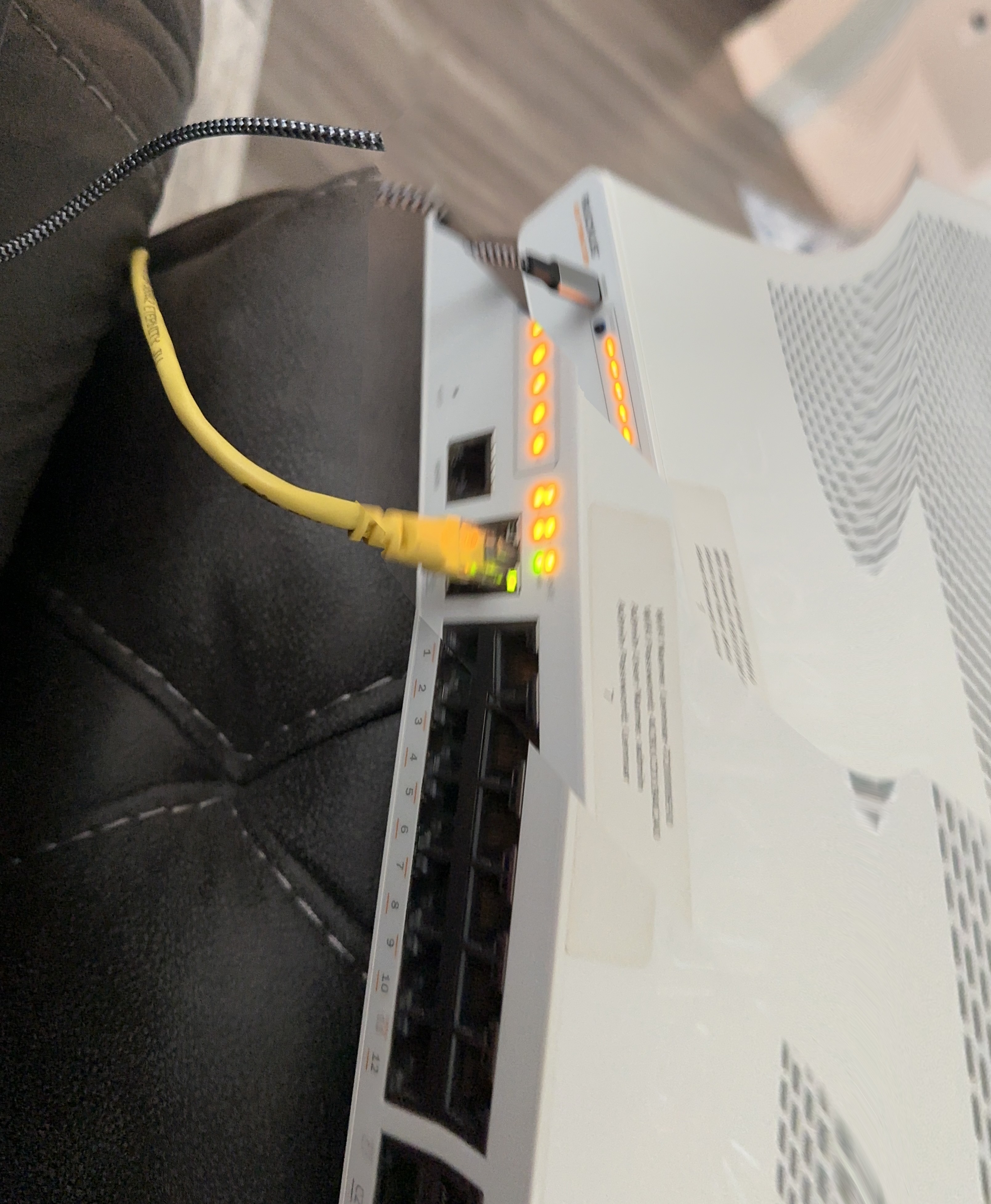

Could you please share a picture showing the Software Recovery cable connections between the RUCKUS Switch and the laptop?
11-04-2024 04:59 PM
Hello Imran ,
Sorry for the delay. Was away from pc. Please find attached pictures of the connections. There is no option for adding images.
