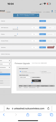

Hello @zsl666  ,
I understand that you are unable to get the AP version details from the individual Access points.
I would request you to please refer to the below mentioned screenshot to get the AP version details:

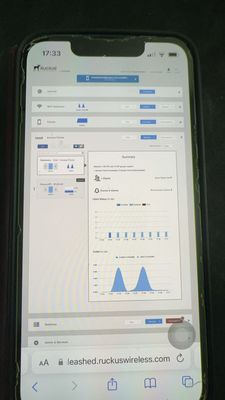

Hi, Please see the screen shot. I can only see one AP in the system. The 2nd ap is connected and still shown as configure.me. Please let me know do I need upgrade the ap system.'
Thank you
Hello @Masni ,
From the response you shared, we understand that your RUCKUS Access Points are on an older version which doesn’t let you manage them. We suggest you upgrade your  RUCKUS R510 Access Point to version 200.15.6.212.27 which is recently released.
Please follow the below RUCKUS Lennar Knowledge base self-help article which will help you to upgrade the Ruckus AP to a recommended version 200.15.6.212.27
https://community.ruckuswireless.com/t5/RUCKUS-Lennar-Support-Knowledge/Upgrade-process-of-the-RUCKU...
We would request you to please select the option “Local upgrade”.
Please click on Local upgrade and you can upgrade the version to the recommended version 200.15.6.212.27.
