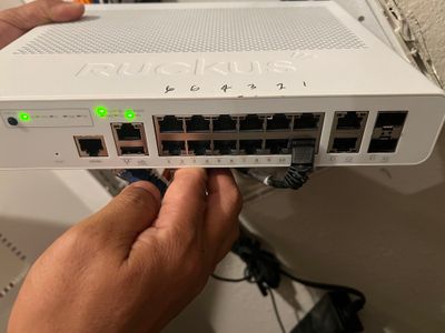

My Smart home system is not working such as no doorbell (ring) but Ruckus unit has green lights. I need help please. thank you

Ariel2023
This one is a clear picture of lights in the unit. 

As you mentioned that on your ICX-7150-C12P Switch, the SYST and PWR lights are steady green, which means the lights are in a normal state.
Since the switch is in the normal state you can take Console access to the switch in order to verify, if the switch is able to transfer the power to PoE devices via 12 ports.

We've followed the steps and here's the result. Please advise what the next steps are. Thank you!
Ports Admin-On: 12
Ports Admin-Off: 0
Ports Oper-On: 1
Ports Oper-Off: 11
Ports Off-Denied: 0
Ports Off-No-PD: 10
Ports Off-Fault: 1
