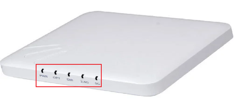

Could you please let me know which device you are seeing Amber lights, ICX-7150-C12P Switch, or Access Point? (Please refer to the below pictures)
Switch:
Access Point:

It looks like the issue is on the switch, there is a green and a amber light on all the time.
When pressing reset for 12 seconds all the lights on the left blink amber.
I was not able to upload image.
dhernz77041
system is orange power is green
