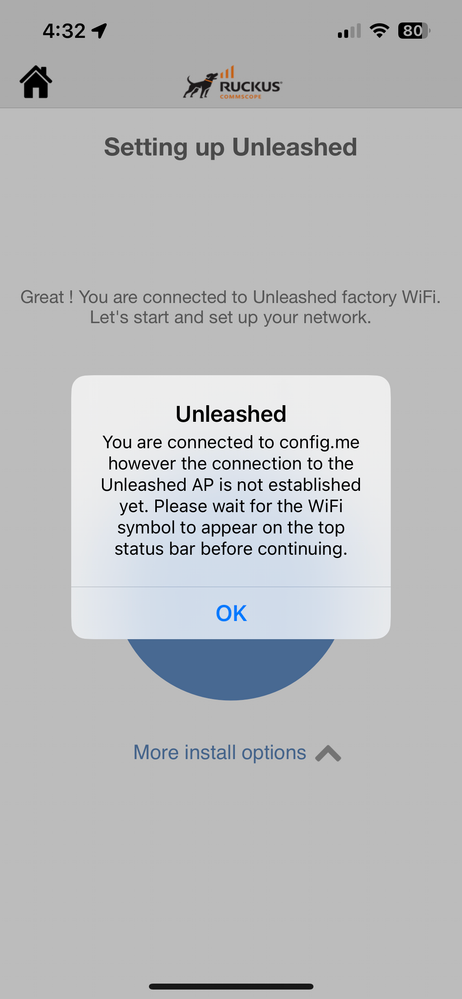

Moved into existing home can't setup R510 access points. I have unplugged both and only plugged in 1 and done the factory reset multiple times.
The Power light is Solid Green, and CTL is flashing Green, no wifi lights will turn on.
I join the Configure.Me-xxxxxx wifi on my iPhone e and launch unleashed app with typical install option and click Start.
