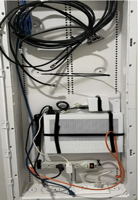

The WAPs depends on a Switch which is the one that provides power, this must be in a cabinet, by default should be the same brand (Ruckus) model ICX7150-12P Switch, may look like the next image:

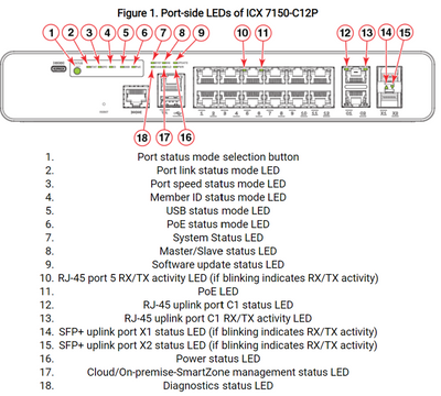

2:In the ICX7150 Switch check if the System light is green, the next image will provide you the location of the ports including the system:

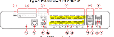

A:Connect the computer from directly to the ICX7150 Switch with an Ethernet cable in one of the 12 port mark with yellow in the next image.

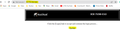

B:once you locate the IP address of the Switch:paste the IP address in the URL bar in your web browser, and hit log in, you can test the next default user and password if it does no work, let me add another set of combinations.
Default User: super
Default Password: sp-admin

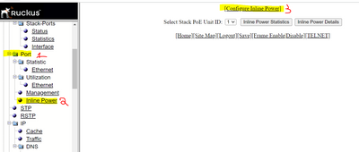

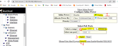

C: Now you are in, let enable PoE:
Click port>inline power>configure inline power>enable> from ports 1/1/1 to 1/1/12>apply>save
Note: the next image will provide the steps too.

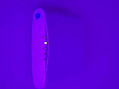

01-25-2023 05:03 PM
Hello,
On the functioning WAPs, the lights for PWR, CTR, 2.4 and 5G are all illuminating. On the one WAP with no function, the PWR is flashing and the CTR is static, no other lights are illuminated. I’ve attached some images. The one is of a working WAP and the other is of the non-working, it has the blue dot sticker on front.
