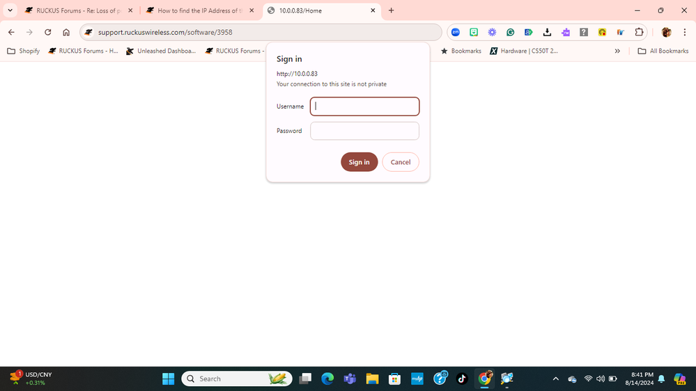

I get to this spot and this is where I have tried all passwords that I created and even those in other posts like username- super or admin and password- sp-admin, Ruckus, Ruckus!, ruckus and a few others. Nothing has allowed me to get past this point. What else can I try? Resetting the system again?

From the response you shared, I understand that you are unable to login to the Switch through web browser with your login credentials.
Also, you have tried with the default credentials combinations too.
We do not need any login credentials to access CLI using the Telnet option. If Telnet is enabled on the Switch it can be accessed directly using an IP Address of the Switch.
Once you identify the Ip address of the Switch using the article I shared in the previous post, you can try accessing CLI using the Telnet option.
