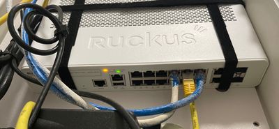

On the switch there are amber and green lights. I will try to upload a photo for details.

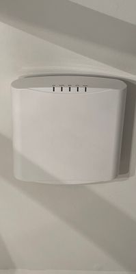

There are two access points neither have any lights on. I have tried powering down the switch and reconnecting all plugs and still both access points remain fully dark.
08-16-2024 07:56 AM
photos of current status.

Hello @Ken ,
From the response you shared, I understand that the status lights on the Switch is Amber and the PWR light is Green, which means that the Switch is stuck in a boot mode
Please follow the below RUCKUS Lennar Knowledge base self-help article which will help you to fix the issue when the Switch is in boot mode.
Please follow the process as explained in the article and let me know if you have any queries in this regard.
